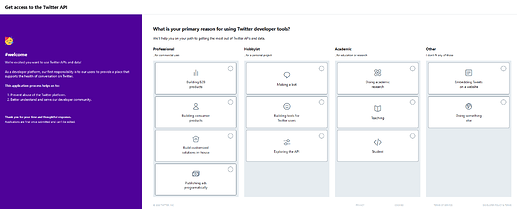

Go to https://developer.twitter.com/en/portal/projects-and-apps
Create the Twitter application
Click + Add Project
Complete the 4 steps.
  1. Complete the three next steps:

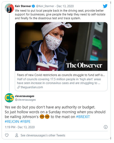

Hi I’m trying to embed a reply to a tweet.
The embed should look like this.
I just get the reply. Not the original Tweet too.
Is this just the way it works on Discourse or am I doing something wrong?
I don’t use Twitter, but I assume the reply link is different from the original tweet’s link. Therefore, you are only linking to the reply. Does linking to the original tweet also include the first reply or just the original tweet?
Hi Jimpas,
No the idea is that if you embed the reply you can choose to have the original tweet above it as in the pic. So the reply has context.
I quite like the styling too.
I’m just getting the reply.
A workaround is two embeds.
That is indeed a work-around. But how can you choose to have the original tweet above a reply? So how would one “choose”? I do see at times someone posts on another website that the original tweet has the first reply to it. :thinking:
