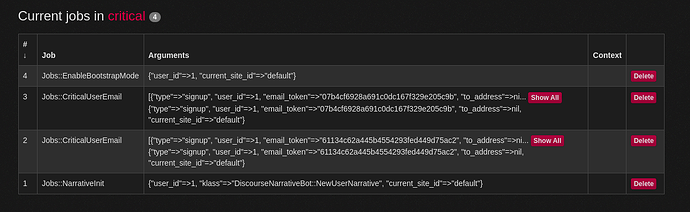

  3. attempted to activate admin account and sideqik reveals this (with token redacted):
    {“type”=>“signup”, “user_id”=>1, “email_token”=>“REDACTED”, “to_address”=>nil, “current_site_id”=>“default”}
Not sure why nil is a thing for to_address.
Any tips, advice, or suggestions would be most welcome!

Sorry for the delayed response. The job that triggered it was: Jobs::CriticalUserEmail
So I followed the guide exactly. When it came to registering the admin account, it did not send an email, and Jobs::CriticalUserEmail contained {“type”=>“signup”, “user_id”=>1, “email_token”=>“REDACTED”, “to_address”=>nil, “current_site_id”=>“default”}.

Started GET "/sidekiq/queues/critical" for REDACTEDPUBLICIP at 2024-09-26 08:13:15 +0000
In the log there, it does show accurate email for the registartaion parameters, but sideqik still reports “to_address”=>nil

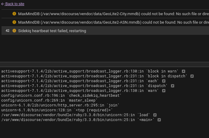

Are there any errors on your site’s Error Logs page? That page is at /logs. You can get there from the admin sidebar by clicking the Security / Error Logs entry.
Oh interesting. I get this:

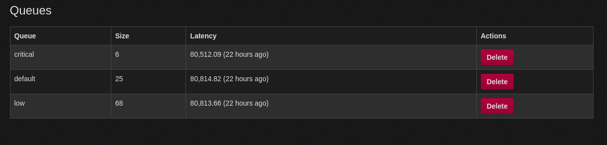

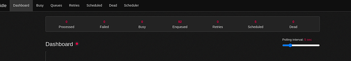

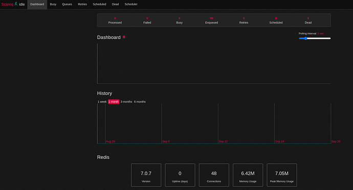

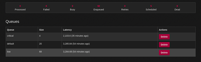

Are you able to access the Sidekiq web interface at /sidekiq ? If so, are there any errors being reported on that page?
I am, but what I get is this:

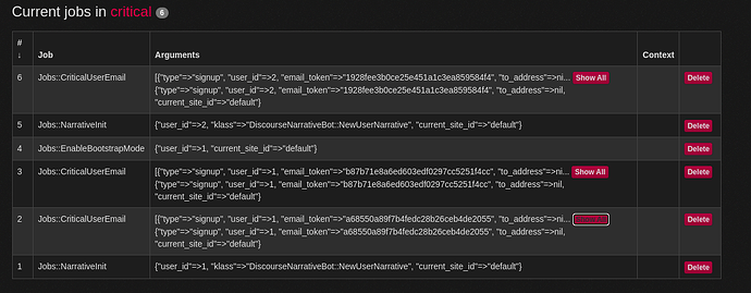

Try clicking on the “Enqueued” tab. It’s a link.
I get this:
Which is where I discovered the address_to=nil thing.
There’s something wrong with Redis and/or Sidekiq. There are a few other members of this forum who might have ideas about how to debug the issue.

  43. Go to discourse.domain.dev/logs - see "Sidekiq heartbeat test failed, restarting`
  44. Go to discourse.domain.dev/sidekiq: See:
  45. Go to view Enqueued
  46. Click on “critical” and expand content and see “to_address”=>nil again.
