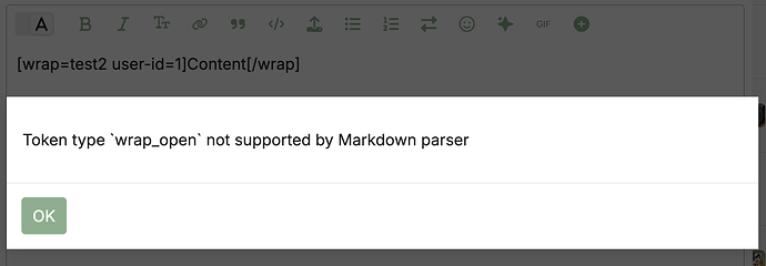

Description: Creating custom token types, which previously worked fine with just the markdown-it engine, causes errors with ProseMirror. As without a ProseMirror schema to handle the parsed to DOM, any custom token types create an error. Similarly there are behavior issues when toggling between RTE and Markdown with BBCode.
Reproducible steps:
RTE First:
  1. Open Editor
  2. Set mode to RTE
  3. Insert custom BBCode.
    a. For example with Discourse Meta: [wrap=test2 user-id=1]Content[/wrap]
  4. Dismiss error and toggle between RTE and md mode.

Ik krijg een vergelijkbaar foutbericht als ik de Gallery-tag [grid] in Markdown toevoeg en mijn bericht vervolgens opnieuw bewerk in WYSIWYG-modus.
I understand the issue is known and worked on, I just add the actual error message:
No parser processed bbcode_open token for tag: div, attrs: [["class","d-image-grid"]]
For folks who will search this string on meta after experiencing this issue (like I just did). :slight_smile:
