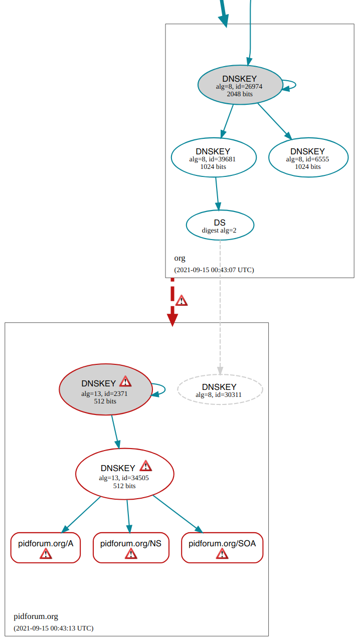

I ran a check here. You can see where the KeyTag 30311 is in the results.
Error: DNSKEY 2371 signs DNSKEY RRset, but no confirming DS RR in the parent zone found. No chain of trust created.
Fatal error: Parent zone has a signed DS RR (Algorithm 8, KeyTag 30311, DigestType 2, Digest p13rHPfOPulImZQcfpK3Kn6Dp7Xc03F9ZzGAS02FHkY=), but the destination DNSKEY doesn't exist or doesn't validate the DNSKEY RR set. No chain of trust created.
