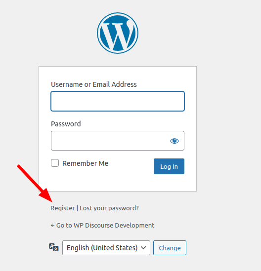

Clicking the Continue button redirects the user to the DiscourseConnect auth site (WordPress) for authentication.
For this test, I’m assuming that the invited user has not yet registered an account on WordPress, so they will need to click the Register link:

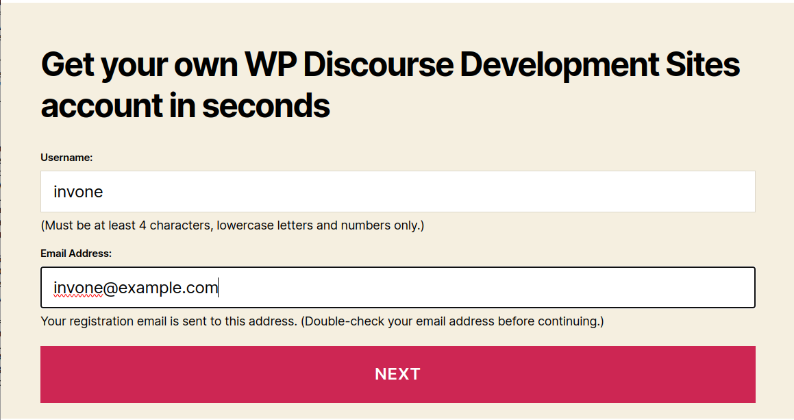

I’m testing this on a WordPress multi-site setup, so the registration form looks different than for a single-site setup:
From here, the user has to go through the process of confirming their email address with WordPress and then logging into WordPress. They can then login to Discourse, but the context of having initiated the process by accepting an invitation to the Discourse site is gone. They can go back to the Discourse site, click the Log In button and be logged into Discourse without any issues, but unless instructions were added to WordPress to guide the user, I think it would be very confusing.
