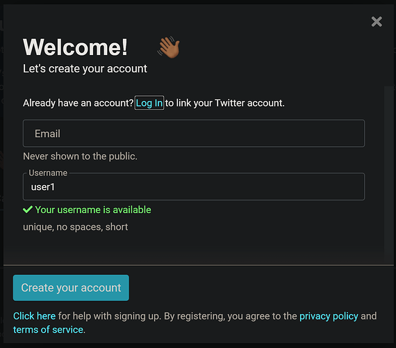

It seems to work except on signup it doesn’t fill the email field automatically? Am I doing something wrong? Works with my google signup, where it populates email automatically.

See @dnfoz’s example. It is down to the fact that every SSO provider is different, meaning how Google does it is a bit different than Twitter, and Twitter is among the worst if not the worst. Twitter’s API is a moving target because Twitter doesn’t know what the heck they are doing and Twitter shows no courtesy to the developers building around their API. So, being brutally honest with you, unless us Discourse admins or the Discourse team are constantly birddogging this plug-in for changes upstream on Twitter’s end, it will constantly break like this.

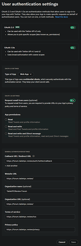

So strange. I am still getting the weird behavior on my website. It’s production, so I cannot toggle too many things, but I will do my best to try to figure it out. It must not be all that unique if other users are also reporting this though.

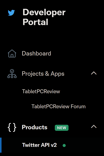

Compared to the parent post here, Twitter has visually changed how settings are configured. This is what I have configured (the setting that are safe to share publicly here in the forum anyway) for my Discourse instance, at least:
 ![image](https://global.discourse-cdn.com/meta/original/3X/b/d/bd4f08c069277ed54347b8bf0001272e2f7b1a8b.png)
EDIT: This might be something. While there is still an option for requesting email from users, there is no longer a setting for _Enable 3rd party authentication_ as mentioned in the parent post. For people who had configured their Twitter login prior to this change in their settings, this might not be a problem since Twitter might grandfather them in and migrate their settings. However, I am not seeing this option anymore which may pose a problem for users like myself and @dnfoz who are configuring our forums for the first time and Discourse needs to have third party authentication to successfully complete the SSO handshaking process.
EDIT 2: Here is another thing to chew on. Is Discourse expecting Twitter API v1 or v2? For new developers, they no longer offer v1 as they only mention migrating for those who were already using v1 with no mention of legacy v1 support for new users. See details here:
> **[X Developer Platform - X](https://docs.x.com/overview)**
> Build, analyze, and innovate with X's real-time global data. Access posts, users, trends, and more through modern APIs with flexible pay-per-usage pricing.
As described at the link above, it would seem that they only allow preexisting developer accounts to migrate v1 over. I see no way or documentation for enabling v2 on new developer accounts and therefore I only have v2 support.
 ![image](https://global.discourse-cdn.com/meta/original/3X/6/f/6f6cfe1329b3834af43e6fc608de7b2b99fb27e7.png)
So, assuming the SSO and embedding is expecting Twitter API v1, this may require some coding effort to support both API releases or sunsetting v1 support if such a dual-pronged approach isn’t possible.

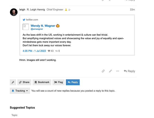

I’m having a problem with this, in that images appear broken. Example:
 ![ScreenShot_2022-07-01_at_15.37.00](https://global.discourse-cdn.com/meta/original/4X/0/d/7/0d7a532cf8b74502591b0f601127a566235c63d9.png)
Any thoughts…? Everything is up to date 😕
