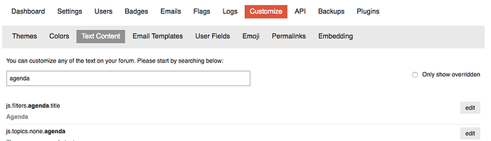

Is it possible to change the name of the list “Agenda” to other name? How?
1 curtida
Yes:
Go to Admin - Customize - Text Content and search for “Agenda”. The first item should be the name of the agenda filter.
(In French it is “Administration - Personnaliser - Contenu”)
6 curtidas
