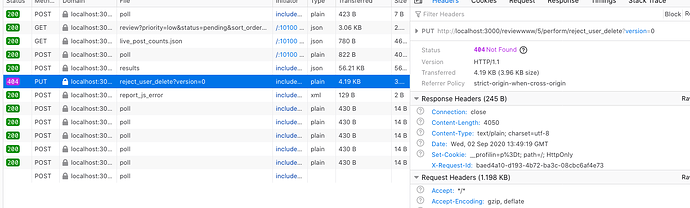

I couldn’t reproduce the issue locally either. The error message makes me think the frontend is making an ajax request to a non-existing endpoint. @bartv Could you share your browser’s network tab after performing the delete action?
I’d like to know if it looks like this:
4 个赞

I removed the Follow Plugin and my issue remained. In the rails log I see:
Started PUT "/review/6793/perform/reject_user_block?version=0" for xx.xx.xx.xx at 2020-09-03 09:45:48 +0000
Processing by ReviewablesController#perform as */*
  Parameters: {"version"=>"0", "reviewable_id"=>"6793", "action_id"=>"reject_user_block"}
Job exception: undefined method `strip' for nil:NilClass
  Rendering text template
  Rendered text template (Duration: 0.0ms | Allocations: 1)
Started GET "/t/global-variables/331828" for xx.xx.xx.xx at 2020-09-03 09:45:48 +0000
Processing by TopicsController#show as HTML
  Parameters: {"slug"=>"global-variables", "topic_id"=>"331828"}
Completed 404 Not Found in 292ms (ActiveRecord: 0.0ms | Allocations: 124598)
ActiveRecord::RecordNotFound (Couldn't find all Topics with 'id': (1185852, 1185853, 1186324, 1186929, 1191089) [WHERE ("topics"."deleted_at" IS NULL)] (found 4 results, but was looking for 5).)
lib/plugin/instance.rb:393:in `block in on'
lib/discourse_event.rb:14:in `block in trigger'
lib/discourse_event.rb:13:in `trigger'
app/models/user.rb:1567:in `trigger_user_destroyed_event'
app/models/reviewable.rb:353:in `perform'
app/controllers/reviewables_controller.rb:192:in `perform'
app/controllers/application_controller.rb:340:in `block in with_resolved_locale'
app/controllers/application_controller.rb:340:in `with_resolved_locale'
lib/middleware/omniauth_bypass_middleware.rb:68:in `call'
lib/middleware/anonymous_cache.rb:336:in `call'
config/initializers/008-rack-cors.rb:25:in `call'
config/initializers/100-quiet_logger.rb:23:in `call'
config/initializers/100-silence_logger.rb:31:in `call'
lib/middleware/enforce_hostname.rb:22:in `call'
lib/middleware/request_tracker.rb:176:in `call'
The ActiveRecord::RecordNotFound line is interesting as it appears every time I try to delete a user from the review queue, and with the exact same topic ID’s.
I checked the topic ID’s and these are all posts that use the Events plugin. And sure enough, one of them has been deleted. I’m puzzled why this action from the review queue would check for these though?
