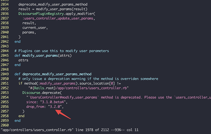

@merefield 嘿,只是提醒您一下,modify_user_params 方法已经弃用一段时间了,并且随着 Discourse 更新到 3.2.0.beta1-dev 版本,它很快就会被移除。
discourse-locations/lib/users_map.rb
35:  def modify_user_params(attrs)
您是否有空将其更新为使用 users_controller_update_user_params 修改器?谢谢!
1 个赞
好的,感谢您的额外提醒,我这周会处理。
1 个赞

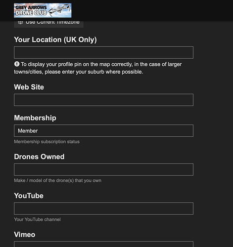

我想编辑这个用户:https://example.com/u/username/preferences/profile
页面加载正常:

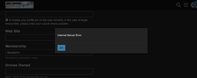

当我点击保存时,我会收到一个错误:

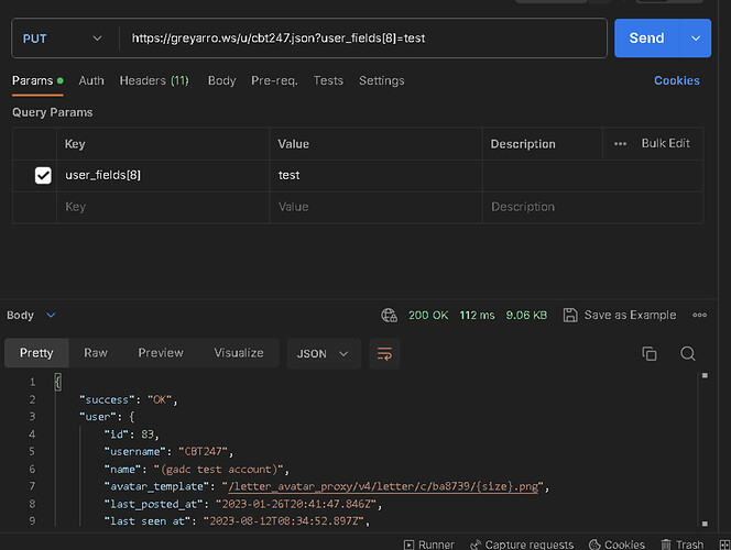

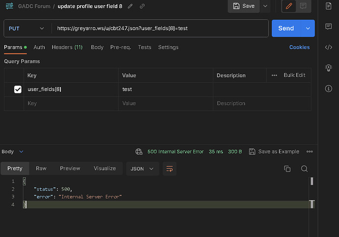

这个问题之所以浮出水面,是因为我们的另一个网站在我们俱乐部门户升级时更新了“membership”自定义字段,而 Discourse API 端点抛出了一个 500 错误。
当我尝试使用 Postman 重现时,这也显而易见了:

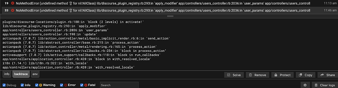

Discourse 日志显示:
和:
plugins/discourse-locations/plugin.rb:188:in `block (2 levels) in activate!'
lib/discourse_plugin_registry.rb:293:in `apply_modifier'
app/controllers/users_controller.rb:2036:in `user_params'
app/controllers/users_controller.rb:198:in `update'
actionpack (7.0.7) lib/action_controller/metal/basic_implicit_render.rb:6:in `send_action'
actionpack (7.0.7) lib/abstract_controller/base.rb:215:in `process_action'
actionpack (7.0.7) lib/action_controller/metal/rendering.rb:165:in `process_action'
actionpack (7.0.7) lib/abstract_controller/callbacks.rb:234:in `block in process_action'
activesupport (7.0.7) lib/active_support/callbacks.rb:118:in `block in run_callbacks'
app/controllers/application_controller.rb:420:in `block in with_resolved_locale'
i18n (1.14.1) lib/i18n.rb:322:in `with_locale'
app/controllers/application_controller.rb:420:in `with_resolved_locale'
activesupport (7.0.7) lib/active_support/callbacks.rb:127:in `block in run_callbacks'
activesupport (7.0.7) lib/active_support/callbacks.rb:138:in `run_callbacks'
actionpack (7.0.7) lib/abstract_controller/callbacks.rb:233:in `process_action'
actionpack (7.0.7) lib/action_controller/metal/rescue.rb:23:in `process_action'
actionpack (7.0.7) lib/action_controller/metal/instrumentation.rb:67:in `block in process_action'
activesupport (7.0.7) lib/active_support/notifications.rb:206:in `block in instrument'
activesupport (7.0.7) lib/active_support/notifications/instrumenter.rb:24:in `instrument'
activesupport (7.0.7) lib/active_support/notifications.rb:206:in `instrument'
actionpack (7.0.7) lib/action_controller/metal/instrumentation.rb:66:in `process_action'
actionpack (7.0.7) lib/action_controller/metal/params_wrapper.rb:259:in `process_action'
activerecord (7.0.7) lib/active_record/railties/controller_runtime.rb:27:in `process_action'
actionpack (7.0.7) lib/abstract_controller/base.rb:151:in `process'
actionview (7.0.7) lib/action_view/rendering.rb:39:in `process'
actionpack (7.0.7) lib/action_controller/metal.rb:188:in `dispatch'
actionpack (7.0.7) lib/action_controller/metal.rb:251:in `dispatch'
actionpack (7.0.7) lib/action_dispatch/routing/route_set.rb:49:in `dispatch'
actionpack (7.0.7) lib/action_dispatch/routing/route_set.rb:32:in `serve'
actionpack (7.0.7) lib/action_dispatch/journey/router.rb:50:in `block in serve'
actionpack (7.0.7) lib/action_dispatch/journey/router.rb:32:in `each'
actionpack (7.0.7) lib/action_dispatch/journey/router.rb:32:in `serve'
actionpack (7.0.7) lib/action_dispatch/routing/route_set.rb:852:in `call'
lib/middleware/omniauth_bypass_middleware.rb:74:in `call'
rack (2.2.8) lib/rack/tempfile_reaper.rb:15:in `call'
rack (2.2.8) lib/rack/conditional_get.rb:40:in `call'
rack (2.2.8) lib/rack/head.rb:12:in `call'
actionpack (7.0.7) lib/action_dispatch/http/permissions_policy.rb:38:in `call'
lib/middleware/anonymous_cache.rb:389:in `call'
lib/middleware/gtm_script_nonce_injector.rb:10:in `call'
rack (2.2.8) lib/rack/session/abstract/id.rb:266:in `context'
rack (2.2.8) lib/rack/session/abstract/id.rb:260:in `call'
actionpack (7.0.7) lib/action_dispatch/middleware/cookies.rb:704:in `call'
actionpack (7.0.7) lib/action_dispatch/middleware/callbacks.rb:27:in `block in call'
activesupport (7.0.7) lib/active_support/callbacks.rb:99:in `run_callbacks'
actionpack (7.0.7) lib/action_dispatch/middleware/callbacks.rb:26:in `call'
actionpack (7.0.7) lib/action_dispatch/middleware/debug_exceptions.rb:28:in `call'
actionpack (7.0.7) lib/action_dispatch/middleware/show_exceptions.rb:29:in `call'
logster (2.12.2) lib/logster/middleware/reporter.rb:43:in `call'
railties (7.0.7) lib/rails/rack/logger.rb:40:in `call_app'
railties (7.0.7) lib/rails/rack/logger.rb:27:in `call'
config/initializers/100-quiet_logger.rb:20:in `call'
config/initializers/100-silence_logger.rb:29:in `call'
actionpack (7.0.7) lib/action_dispatch/middleware/remote_ip.rb:93:in `call'
actionpack (7.0.7) lib/action_dispatch/middleware/request_id.rb:26:in `call'
lib/middleware/enforce_hostname.rb:24:in `call'
rack (2.2.8) lib/rack/method_override.rb:24:in `call'
actionpack (7.0.7) lib/action_dispatch/middleware/executor.rb:14:in `call'
rack (2.2.8) lib/rack/sendfile.rb:110:in `call'
actionpack (7.0.7) lib/action_dispatch/middleware/host_authorization.rb:131:in `call'
message_bus (4.3.7) lib/message_bus/rack/middleware.rb:60:in `call'
lib/middleware/request_tracker.rb:233:in `call'
railties (7.0.7) lib/rails/engine.rb:530:in `call'
railties (7.0.7) lib/rails/railtie.rb:226:in `public_send'
railties (7.0.7) lib/rails/railtie.rb:226:in `method_missing'
rack (2.2.8) lib/rack/urlmap.rb:74:in `block in call'
rack (2.2.8) lib/rack/urlmap.rb:58:in `each'
rack (2.2.8) lib/rack/urlmap.rb:58:in `call'
unicorn (6.1.0) lib/unicorn/http_server.rb:634:in `process_client'
unicorn (6.1.0) lib/unicorn/http_server.rb:739:in `worker_loop'
unicorn (6.1.0) lib/unicorn/http_server.rb:547:in `spawn_missing_workers'
unicorn (6.1.0) lib/unicorn/http_server.rb:143:in `start'
unicorn (6.1.0) bin/unicorn:128:in `<top (required)>'
vendor/bundle/ruby/3.2.0/bin/unicorn:25:in `load'
vendor/bundle/ruby/3.2.0/bin/unicorn:25:in `<main>'
