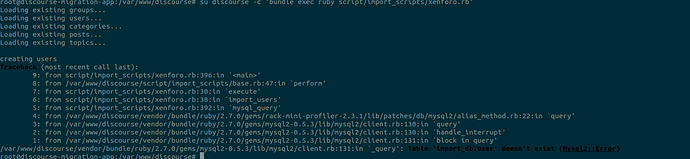

I’m getting an error that users table doesn’t exist when I run the xenforo script. Any help really aprreciated!
Reading about this for an hour but haven’t figured it out yet.

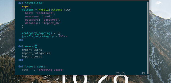

There are some variables at the top of the script that you need to fill in so that it can connect to your xenForo MySQL database and query the data. I believe “import_db” might be the placeholder value - double check that those values are filled out correctly.
3 个赞
@Ghan I thought I’m importing to import_db with this: mysql -u root -p import_db < /shared/db.sql
My xenforo.rb is:
Ah ok. If that is your database name, then check to make sure you have the table name correct. Your table might be xf_user with the prefix, and that would cause an issue. There should be a TABLE_PREFIX variable in the script as well.
4 个赞
@Ghan Thanks you!

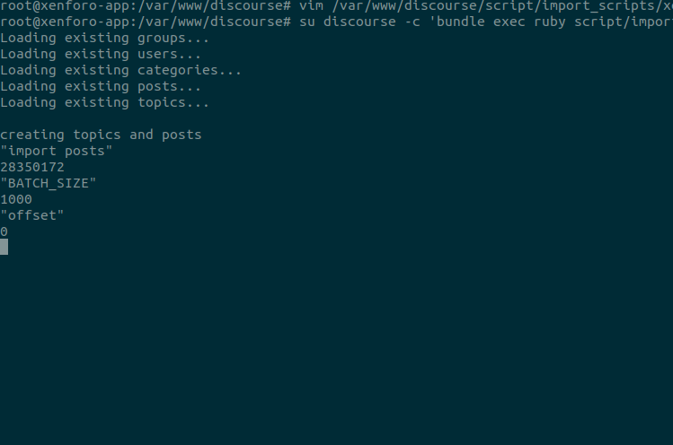

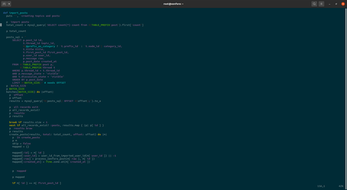

Right now, I’m still stack on the import script.
It iterates through users and categories all good. On the import_posts function though it just hangs there until after some hours it times out.
Starting debugging this by just printing the values in the import_posts:
All prints after the assignment of the results variable never print.
