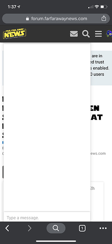

Actually, after updating the server, the issue returned. It also occurs on all my mobile browsers:
