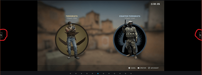

Yes, I use the latest version - v2.2.0.beta8
Check this screenshot:
Ah, well, that’s not the same component, it’s the Slick image gallery component. (And yes, icons are broken for that component. Will work on a fix.)
