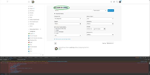

Hey Robert, it seems that the error is still here :frowning: :
Note that I updated the component on the test site deployed 2 days ago, and I had the same error. I re-deployed the site a few minutes ago and reinstalled the theme component, but the advanced search still doesn’t work when the component is active, and the error is still visible.

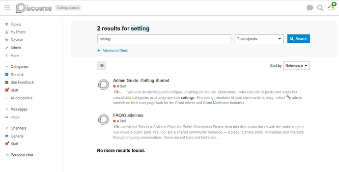

that’s very strange, going to update my site right now to double check and will revert
No problems on my daily pristine deployment either.

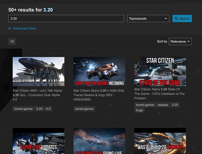

No issues on StarZen, e.g: https://www.starzen.space/search?q=3.20
but this has sidecar installed … still investigating if this fails without …

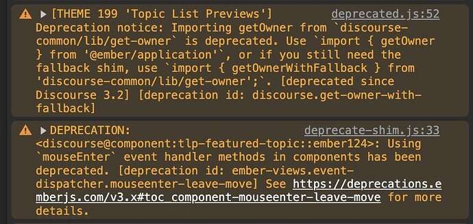

This seems to be broken again:
Only relevant items:

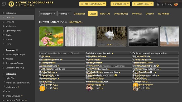

Thanks Rob, I’m still seeing the issue though. No more related errors in the console…
That suggests your javascript is breaking somewhere.
it’s not failing on Starzen, which I’ve just rebuilt, so I can only assume it’s some javascript from some other component you’ve got which is interfering with it?
Do you use Layouts? I’ve also deployed the import update to that this evening.
You have no other suspicious output on console?
Have you made any other changes, introductions of new components?
I’m assuming you’ve tried fully rebuilding?
Sorry, I should have checked other components. It’s caused by a conflict with Topic List Author which I’ve removed from themes using TLP, no problem. FYI @Lilly
No worries, the work needed doing anyway, and now the console is all clean! :chefs_kiss:
Hah I was just testing this and was about to post here that the two components are not compatible at the moment because both override the topic-list-item template.
