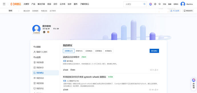

Yes, I submitted feedback to the official channels requesting that the service provider offer port 587 for email push services.
