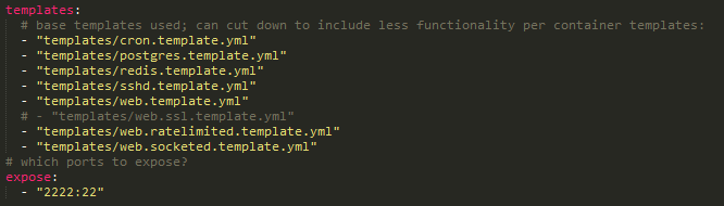

I had the exact same issue using steam, you see how you’re doing 26789 :80, the method I linked, uses the discourse functionality and uses sockets. It removes the :26789 from the end of the URL and it work’s fine again :smiley:
My app.yml:
Example YML
Very basic nginx config “/etc/nginx/conf.d/discourse.conf”:
