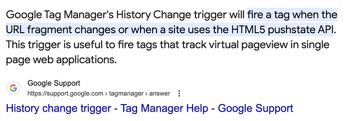

Whereas the tags that are set to “History” aka “all” trigger seem to trigger with each page change, from page to page, and also when you trigger an infinite scroll.
Here’s the GTM definition of the HISTORY (ALL) trigger:

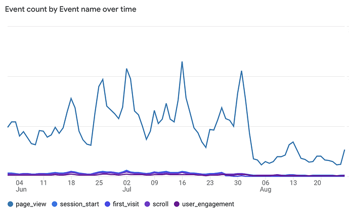

  • Google Analytics GA4: had 152K PageViews
  • Google Analytics GA4: had 6.8K First Visit Events
  • Discourse Logged: 93K Page Views
  • Google AdSense: 6K Page views
That first visit event and the AdSense Page Views seem remarkably similar - is Google AdSense tracking anything outside the first page load of each visit?
EDIT to add some early data on my Adsense - GTM Adsense
Google Analytics page views from June 2 to August 26 - you can see where the high profile part of the season ends July 31st = 211K Page views:

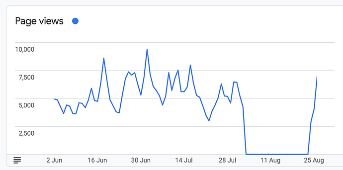

Google AdSense page views:
NOTE:
  • I was using the official plugin up to July 31
  • I removed Adsense Aug 3 to Aug 23 = the bottoming out.
  • Added Adsense with Google Tag Manager Aug 24
You can see that despite the major issues in the screencast above, and with much lower overall traffic I’m getting a much higher Adsense Page view proportionately per GA4 Page view using GTM to attach Adsense than I was with the official plugin.
