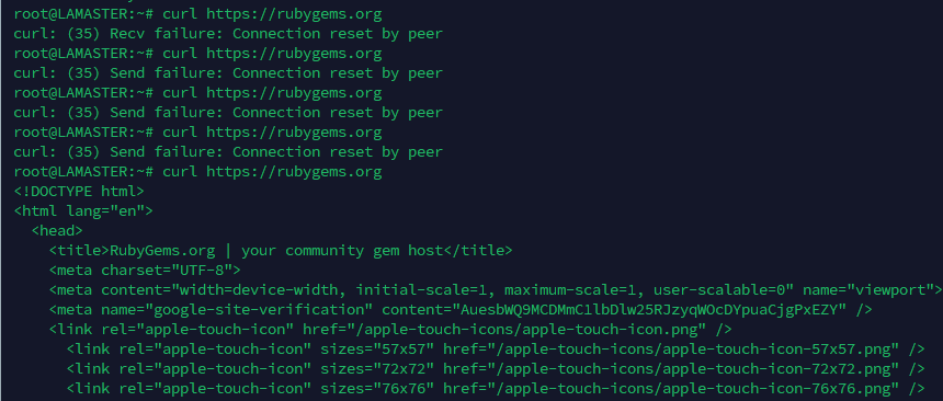

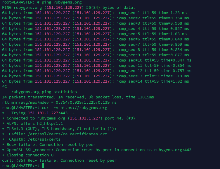

root@LAMASTER:~# curl -v https://rubygems.org
*   Trying 151.101.1.227:443...
* Connected to rubygems.org (151.101.1.227) port 443 (#0)
* ALPN: offers h2,http/1.1
* TLSv1.3 (OUT), TLS handshake, Client hello (1):
* Send failure: Connection reset by peer
*  CAfile: /etc/ssl/certs/ca-certificates.crt
*  CApath: /etc/ssl/certs
* OpenSSL SSL_connect: Connection reset by peer in connection to rubygems.org:443
* Closing connection 0
* Send failure: Broken pipe
curl: (35) Send failure: Connection reset by peer
*   Trying 151.101.193.227:443...
* Connected to rubygems.org (151.101.193.227) port 443 (#0)
* TLSv1.3 (IN), TLS handshake, Server hello (2):
* TLSv1.3 (IN), TLS handshake, Encrypted Extensions (8):
* TLSv1.3 (IN), TLS handshake, Certificate (11):
* TLSv1.3 (IN), TLS handshake, CERT verify (15):
* TLSv1.3 (IN), TLS handshake, Finished (20):
* TLSv1.3 (OUT), TLS change cipher, Change cipher spec (1):
* TLSv1.3 (OUT), TLS handshake, Finished (20):
root@LAMASTER:~#
Does this help?
Thanks. I will try it. Actually, my server is in Los Angels.
Network is fine. But SSL isn’t.

Sorry, not sure how to help with this, it seems like an issue with your server or ISP. Is the SSL issue limited to rubygems.org, do you know?
1 лайк
When I enable IPV6 it works. Thanks a lot.
