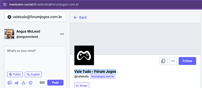

I’ve just looked up “valetudo@forumjogos.com.br” on mastodon.social a couple of times and the name has been successfully changed. It looks like you’re testing out a few different names. It’s currently “Vale Tudo - Fórum Jogos”.
:point_right: Tip: If the actor details are not updating for some reason, you can force any Mastodon instance to get the latest version of your actor by doing a search for your actor’s handle on that instance. Mastodon will update it’s local copy of a remote actor when you do that.
Note that we’ll be adding explicit Update > Actor support (which will make this happen in realtime) soon.

I just saw it. I have tested now on the app and it’s works. Thank you Angus

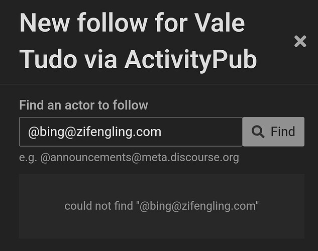

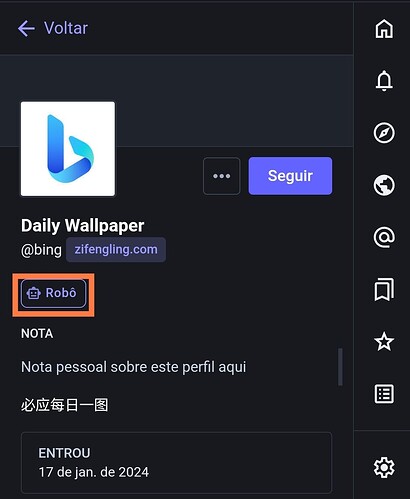

Can it works to federate bot accounts?
I searched for 3 bot accounts handle to federate, and always get a “Could not find” error. But it’s works with accounts not tagged as bot

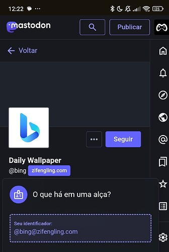

There’s a example. A bot account i cant find and follow. I have already searched for 5 others bots, but none works
Another example: wallpapers@mastodon.social
إعجابَين (2)
Thanks for explaining. Yes, that’s expected currently. We’re slowly adding more support as the need arises, and as we think through the implications. Currently we have not yet allowed Discourse actors to follow Service actors (which is what Mastodon marks the accounts you’ve referred to as being). We may add support for them soon.

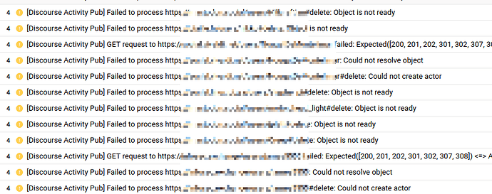

I see in the log tons of those errors.
At same time I can’t change the owner of a thread and online seems that the reason is this plugin.
I am the admin so I should be able to do it.
