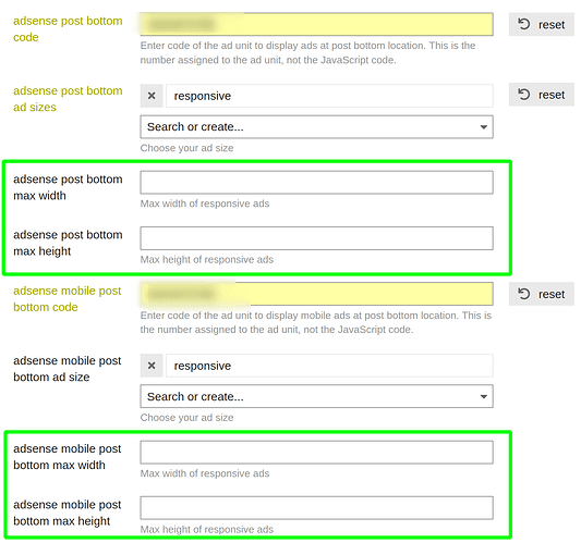

The UI proposal is to add max size parameters to the Discourse settings UI, instead of the current selection menu where you have a handful of fixed sizes available. Would de-clutter the UI, as responsive would be the default, with the possibility to limit the height.

I think I understand this. So what we would end up with is this:
The big problem with responsive ads currently is that it causing jumping in the page layout, which is horrible within a topic while you’re trying to read. I’ll try adding these new settings to see if it prevents the jumping, but I have my doubts about max height helping because a smaller add will cause the placements to shrink.

@ljpp I implemented what you suggested, and it simply doesn’t work. Not even a little bit.
I followed this article to try to implement something like the example. See this result, where I’ve included some debugging to show what the ins element’s inline-style attribute contains when the adplugin renders it:
Here are my settings:
Notice the final result after AdSense has finished its work has a fixed height of 280px, replacing the 90px that the initial ins style had. And AdSense didn’t even find an ad to show, but decided to make the div bigger anyway. :man_facepalming:
And anyway, these new settings don’t streamline the AdSense settings, they add a lot more that are even more confusing and don’t actually let you control the sizes with the new way that responsive ads work.
8 个赞
