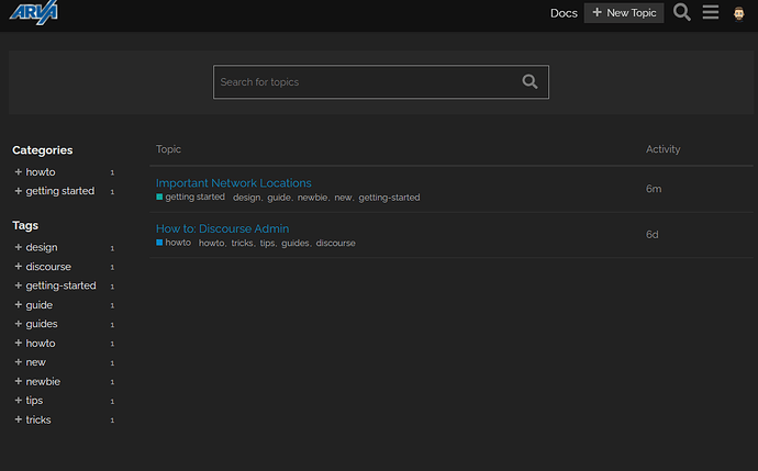

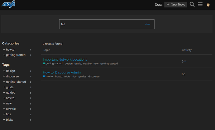

  1. search for some information:

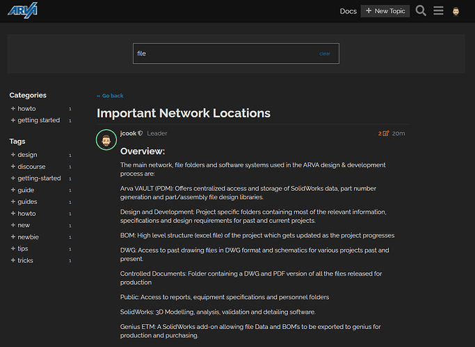

  2. I click on the topic I want to view:
  3. When I return to the knowledge base page. The results from the search are still present and I have no way to clear it except by refreshing the page. The clear button is no longer present.

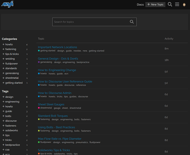

Edit: KB page usually looks like this:
