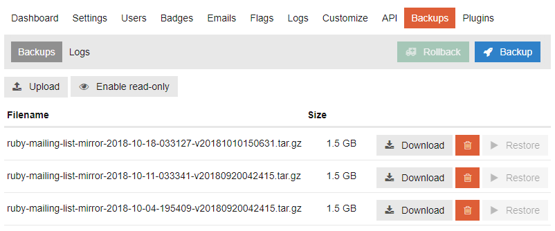

Além disso, a guia \u003ckbd\u003eBackups\u003c/kbd\u003e agora funciona da mesma forma para qualquer local de backup.
Não há mais necessidade de fazer login na Amazon S3 para fazer upload, download ou excluir um backup. Você pode até mesmo restaurar um backup diretamente do S3.

Clarification on how this works when settings are changed:
  1. When once switches from S3 to Local or vice versa, do the existing backups get transferred or are they removed or are they left alone?
  2. When one see’s the list of backups in the Backup page is there a way to tell the location or are they all from the selected location in the setting?
  3. What is the meaning of this setting given that backups are no longer “synced” and either on S3 or Local? Disable the removal of backups from S3 when removed locally.
2 curtidas
Existing backups won’t be touched. You need to delete them manually if you want to free up space.
Only from the selected backup location.
The description of the s3_disable_cleanup setting needs an update. It disables the removal of backups from S3 and makes the system ignore the value of maximum_backups when backup_location is set to S3.
