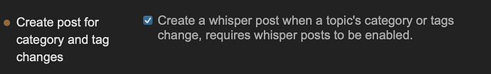

Repro steps:
  1. Turn on this setting
  2. Change a tag of a topic (add/remove)
  3. The whisper post is created as expected

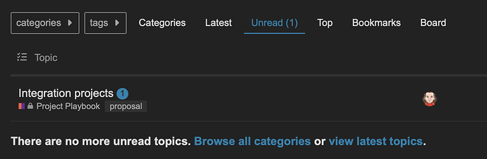

  4. Go to the homepage
  5. Sometimes you need to refresh the browser
  6. The topic appears in your Unread category
Expected behavior:
As it was YOU who changed the tag there is no need to put it into the Unread category. I think it would be correct to display for anybody else (who can see the whisper).
