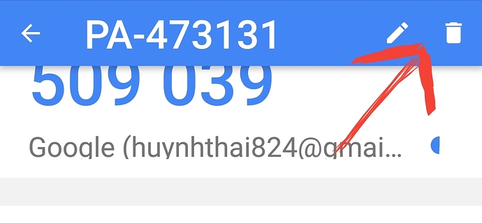

Hello everyone,
I have mistake that i delete Google Authentication Discourse on Mobile so Now i can’t login to Discourse.
My question is … Can we disable Two Factor Authentication by command line SSH ?
Thank you!

What happened to your backup codes?
I delete my Google authentication
And i don’t save backup code

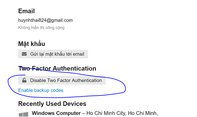

I want to disable two factor authentication all of account Discourse
