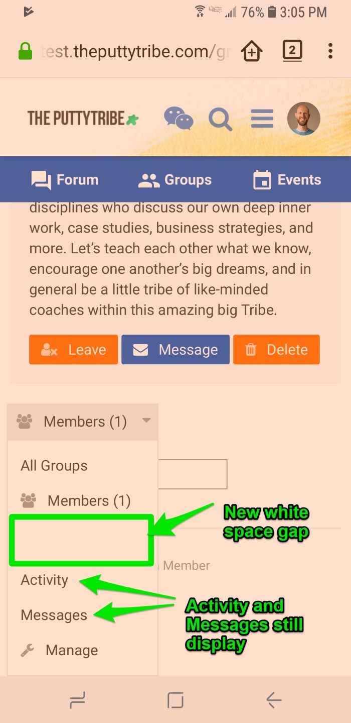

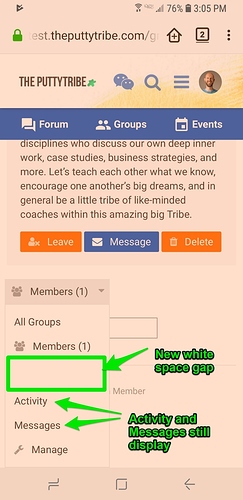

The screen shots below show how it worked at least functionally in desktop view and didn’t work so well in mobile view. Is there another way to approach hiding the Activity and Messages elements – preferably for all groups at once instead of new templated lines of CSS for each group?

Thanks for the display: none; tweak, @dax. That helped on desktop view, which now looks like this.
However, mobile view still shows the Activity and Messages options in the drop-down list, and frustratingly, the empty white space that was there before (which must be default theme or environmental related).
Do you know why the CSS would work on desktop view and not mobile view? And do you know if there’s a way to use a wildcard in the CSS to apply the display: none; code to all groups instead of going one-by-one?
Yes, they use separate CSS and different selectors. Lots of styling differs between mobile and desktop view, that’s part of how responsive design works.
If you swap to a mobile view on Chrome and inspect elements you can identify how it changes and produce the mobile-friendly alternative.
FYI everyone. Here’s the CSS to hide the Messages and Activitiy tabs on desktop and mobile view.

Mobile
.mobile-nav .activity.ember-view, .mobile-nav .messages.ember-view{
    display: none !important;
