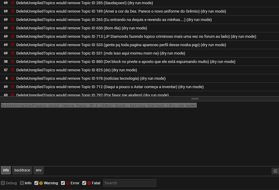

I finally installed this plugin, so far in dry run mode. It seems correctly to identify the topics to delete.
In the logs each line like DeleteUnrepliedTopics would remove Topic ID *number* (*topic title*) (dry run mode) is preceded by the X indicator for an “Error”. I’d have expected it be “Info” or even “Warning”.
@RGJ Is that expected? Thanks. I’m using the latest version of Discourse.
1 „Gefällt mir“
Yes, that seems to be by design. I vaguely remember that there was some issue with debug levels so I made it to be an error. Sorry for any confusion!
