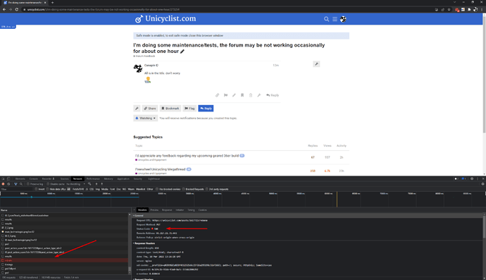

I’m not sure if I should post in the chat plugin category instead of here.
But anyway, installing the official plugin leads to errors 500 when trying to rebake posts.
See: Importing / migrating from phpBB3 - #678 by Canapin
Even in safe-mode with the plugin disabled.
I installed the chat plugin in another instance, and it triggered the issue as well so I’m kind of 100% sure the issue comes from the plugin.
After installing it on my other forum to test:
