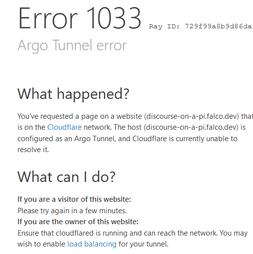

Your website is offline.
Also if it’s accurate happy birthday :tada:
5 إعجابات
Oh thanks for the reminder. It got lost when I moved houses a few months ago. Turned it on again just now and updated it to latest.
Thanks!
