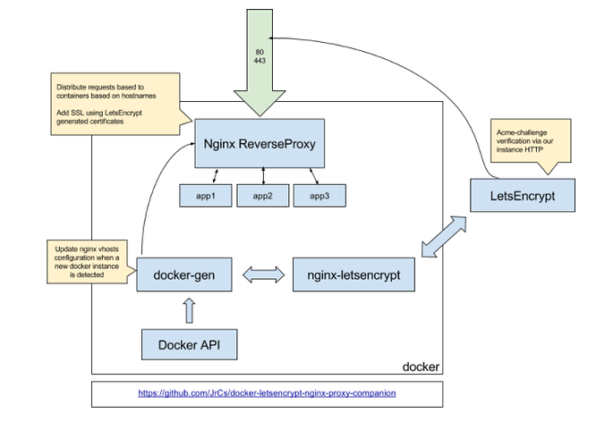

关于这些组件如何协同工作的良好示意图,可以参考以下页面:

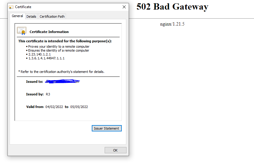

我的证书已成功生成,如下所示,但我目前收到 502 错误。

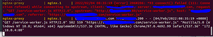

我的 Docker 日志显示以下内容,这似乎是到目前为止最有用的信息(我已移除公共 IP 和域名):
nginx-proxy          | nginx.1     | 2022/02/04 08:35:04 [error] 206#206: *93 connect() failed (111: Connection refused) while connecting to upstream, client: {REDACTED_PUBLIC_IP}, server: {MY_FORUM_DOMAIN}.com, request: "GET / HTTP/2.0", upstream: "http://172.18.0.4:80/", host: "{MY_FORUM_DOMAIN}.com"
nginx-proxy          | nginx.1     | {MY_FORUM_DOMAIN}.com {REDACTED_PUBLIC_IP} - - [04/Feb/2022:08:35:04 +0000] "GET / HTTP/2.0" 502 559 "-" "Mozilla/5.0 (Windows NT 10.0; Win64; x64) AppleWebKit/537.36 (KHTML, like Gecko) Chrome/97.0.4692.99 Safari/537.36" "172.18.0.4:80"
nginx-proxy          | nginx.1     | 2022/02/04 08:35:06 [error] 206#206: *93 connect() failed (111: Connection refused) while connecting to upstream, client:{REDACTED_PUBLIC_IP}, server: {MY_FORUM_DOMAIN}.com, request: "GET /service-worker.js HTTP/2.0", upstream: "http://172.18.0.4:80/service-worker.js", host: "{MY_FORUM_DOMAIN}.com", referrer: "https://{MY_FORUM_DOMAIN}.com/service-worker.js"
nginx-proxy          | nginx.1     | {MY_FORUM_DOMAIN}.com {REDACTED_PUBLIC_IP} - - [04/Feb/2022:08:35:06 +0000] "GET /service-worker.js HTTP/2.0" 502 559 "https://{MY_FORUM_DOMAIN}.com/service-worker.js" "Mozilla/5.0 (Windows NT 10.0; Win64; x64) AppleWebKit/537.36 (KHTML, like Gecko) Chrome/97.0.4692.99 Safari/537.36" "172.18.0.4:80"
nginx-proxy          | nginx.1     | 2022/02/04 08:35:19 [error] 206#206: *93 connect() failed (111: Connection refused) while connecting to upstream, client:{REDACTED_PUBLIC_IP}, server: {MY_FORUM_DOMAIN}.com, request: "GET /service-worker.js HTTP/2.0", upstream: "http://172.18.0.4:80/service-worker.js", host: "{MY_FORUM_DOMAIN}.com", referrer: "https://{MY_FORUM_DOMAIN}.com/service-worker.js"
nginx-proxy          | nginx.1     | {MY_FORUM_DOMAIN}.com{REDACTED_PUBLIC_IP} - - [04/Feb/2022:08:35:19 +0000] "GET /service-worker.js HTTP/2.0" 502 559 "https://{MY_FORUM_DOMAIN}.com/service-worker.js" "Mozilla/5.0 (Windows NT 10.0; Win64; x64) AppleWebKit/537.36 (KHTML, like Gecko) Chrome/97.0.4692.99 Safari/537.36" "172.18.0.4:80"
