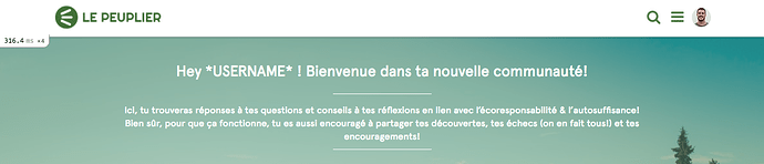

Benutzernamen beim Einloggen im Banner anzeigen
Ich möchte in meinem Banner „hey Benutzername" anzeigen lassen. Wie kann ich das umsetzen? Und der Name soll nicht angezeigt werden, wenn man sich ausgeloggt hat… Danke!

Thanks! But, I tried it and my name doesn’t display.
I copied exactly what you wrote.

When I put the html in the header like you do, I see my name. But I don’t want the banner above the header. I want it after like this tutorial https://meta.discourse.org/t/banner-themes-and-instructions-for-customizing-them/82368 . When I put the code in the “Afther header” I don’t see my name.
And is it possible to see only the first name?
Thanks
Sure, no problem. You can put the HTML code with the <span> in the After Header now, and the code below in the </head>. It displays the first name only. To show their full name, you would get rid of the .split(' ')[0].

This is what I got with After header. I don’t see my name.
This is what I got with header . I see my full name but it is not where I want to place this section.
