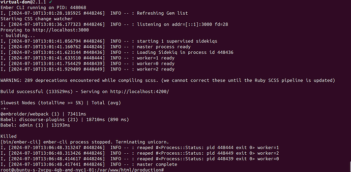

I have successfully configured a local environment, but I am having trouble deploying the “discourse” application on a Digital Ocean server.
I tried to run the below command on a server
Command: DISCOURSE_HOSTNAME=localhost UNICORN_LISTENER=localhost:3000 bin/ember-cli -u
Can you please help me why the process is killed automatically?
Is there any other way to start the server
