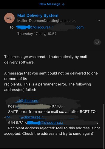

after rebuilding mail-receiver and app this morning, i have been getting the following outcome on email that would have sent previously
i’ve tried this setting but still bounces back
here are the more recent logs

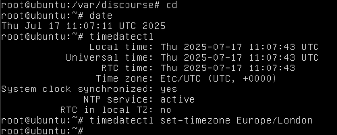

could this be system clock after updating the ubuntu kernel?
yes it was an hour behind
Right, the test email i sent bounced back with the same error, which is clear in .\launcher logs mail-receiver

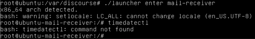

okay so both the mail-receiver container and app container are set to a different time to the host system
host system - correct time :white_check_mark:
app container - wrong time :cross_mark:
mail-receiver container - wrong time :cross_mark:
From: Set timezone for Docker container - #2 by OrkoGrayskull
do as above post
well it’s still different, after rebuilding mail-receiver and causing both - to go yellow

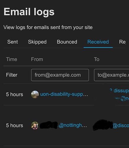

these were the last emails to get in
they appears set to a different time zone, which is fine.
Assuming you ran these commands a couple minutes apart, this looks good.

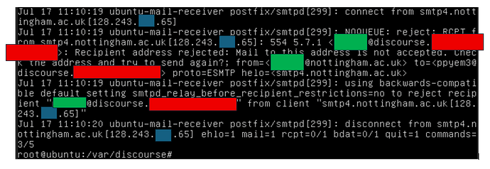

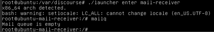

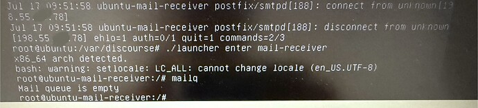

it’s connects to mail-receiver but mail-receiver sees the IP as unknown, so bounces it back, the email doesn’t land in the mail-receiver’s queue.

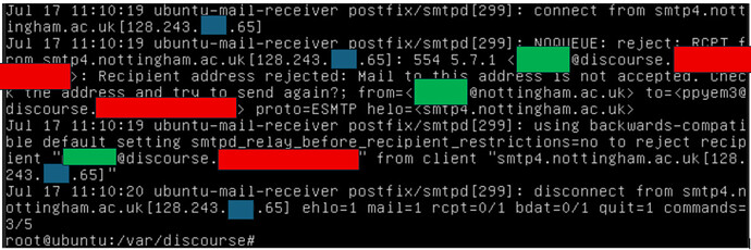

I don’t believe this is correct. It’s a warning, not an error.
This screenshot (please make this text) indicates the address ppyem30@discourse.domain.com is not accepted - that appears to be the reason for the failure.
I’d look more into the using backwards-compatible default setting… line, that seems to be hinting towards the reason.

Jul 17 15:41:32 ubuntu-mail-receiver postfix/smtpd[122]: NOQUEUE: reject: RCPT from btprdrgo001.btinternet.com[65.20.50.6]: 554 5.7.1 <person@discourse.redacted.com>: Recipient address rejected: Mail to this address is not accepted. Check the address and try to send again?; from=<ethan.redacted@btinternet.com> to=<person@discourse.redacted.com> proto=ESMTP helo=<btprdrgo001.btinternet.com>
Jul 17 15:41:32 ubuntu-mail-receiver postfix/smtpd[122]: using backwards-compatible default setting smtpd_relay_before_recipient_restrictions=no to reject recipient "person@discourse.redacted.com" from client "btprdrgo001.btinternet.com[65.20.50.6]"
Jul 17 15:41:32 ubuntu-mail-receiver postfix/smtpd[122]: disconnect from btprdrgo001.btinternet.com[65.20.50.6] ehlo=1 mail=1 rcpt=0/1 data=0/1 rset=1 quit=1 commands=4/6

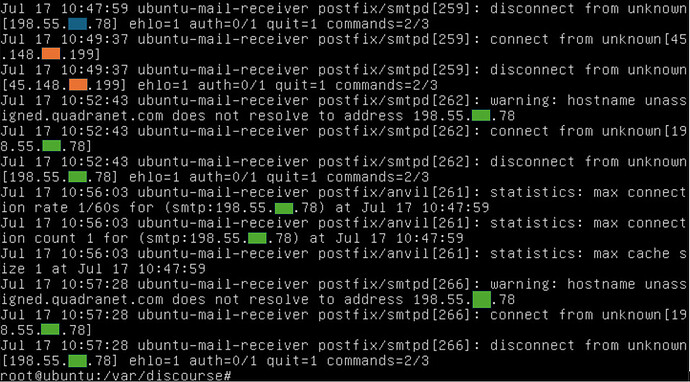

Jul 17 15:42:49 ubuntu-mail-receiver postfix/smtpd[122]: warning: hostname unassigned.quadranet.com does not resolve to address 198.55.98.78
Jul 17 15:42:49 ubuntu-mail-receiver postfix/smtpd[122]: connect from unknown[198.55.98.78]
Jul 17 15:42:49 ubuntu-mail-receiver postfix/smtpd[122]: disconnect from unknown[198.55.98.78] ehlo=1 auth=0/1 quit=1 commands=2/3
Jul 17 15:43:35 ubuntu-mail-receiver postfix/smtpd[122]: connect from unknown[196.251.92.207]
Jul 17 15:43:36 ubuntu-mail-receiver postfix/smtpd[122]: disconnect from unknown[196.251.92.207] ehlo=1 quit=1 commands=2

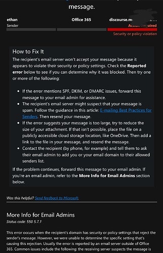

Error Details
Error:	554 5.7.1 <person@discourse.YOURDOMAIN.com>: Recipient address rejected: Mail to this address is not accepted. Check the address and try to send again?
Message rejected by:	ubuntu-mail-receiver.localdomain
