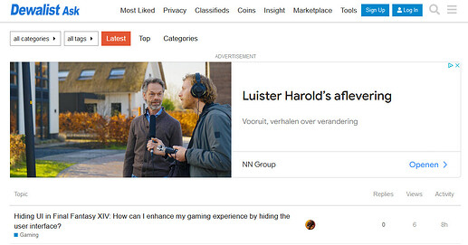

I was going to have another look for you but ads are showing, so better not touch anything anymore :wink:
I think Jakke’s suggestion worked well.
I might remove the CSP from app.yml stuff
