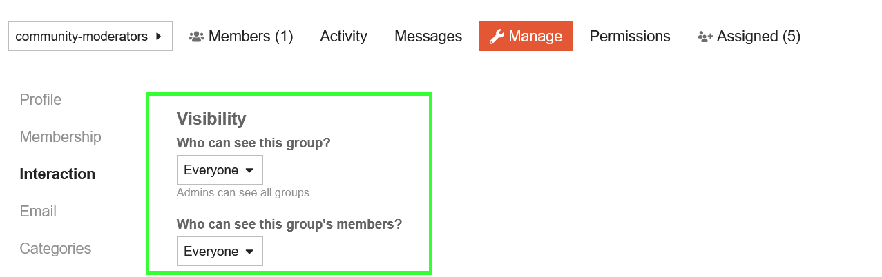

I wonder if it’s a group visibility thing? What are those groups visibilities set as on their /manage/interactions page?
Both items are set as Group Owners for both groups we are dealing with. We want it this way as we don’t want general public knowing how many paid subscriptions we have. Also, this worked perfectly fine like this when we first started using the Ads plugin when it was first released.

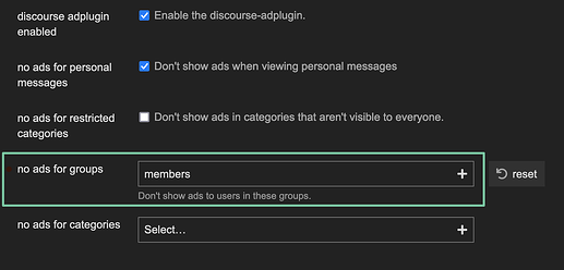

Correct. There isn’t a designated exclude groups for that setting, but no ads for groups is the setting to use to exclude groups for house ads.

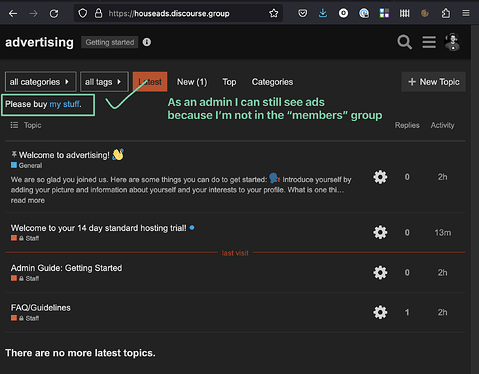

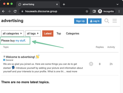

You can visit https://houseads.discourse.group/ and see that ads are showing to anonymous users, and I’ll go ahead and invite you to the members group (check your email) so that you can check it out.

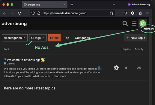

And if I’m logged in as member1 who is a member of the members group, they don’t see any ads:
As an admin I can still see the ads because I’m not in the members group.

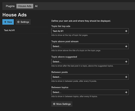

More house ad settings
