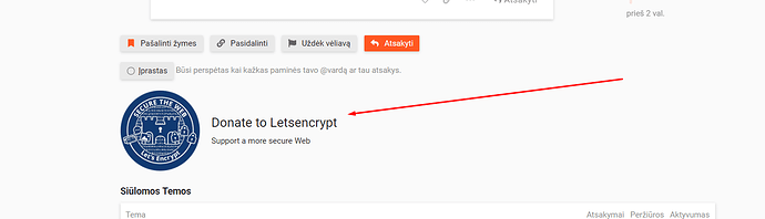

Hi! Our “Topic above suggested” ad is not completely below the “Reply” button by default here?
This is how the ad appears for unregistered or ‘not-logged-in’ users, the ad goes right side.
This is how the ad appears for logged-in users, below the “Watching” button and in a proper centralized way we coded. You can check this on our HBB Forum.
Using extra “margin-bottom” will affect the already perfect one for registered users view. Kindly let me know your thoughts, please.
2 Mi Piace
I’m working on something for this issue, but my browser’s cache is acting weird, I’ll share an update if it works. Thank you. :smiley:
1 Mi Piace
Looks like a problem with your html and/or css. Add css like clear: both;, display: block, etc. whatever is necessary there.
