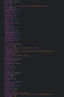

When the callback is fired, Discourse passes the post attributes to it. So, you can, for example, do something like this.
api.addPostClassesCallback((attrs) => {
  console.log(attrs);
If you check the console, you’ll see that it displays the attributes of each post.
These are just examples; there’s more in there.
