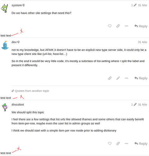

Start by adding the markup to all posts. So something like this
api.decorateWidget("post:after", helper => {
  return helper.h("div", "test text");
</script>
to the header section of your theme. That should be enough to add “test text” below every post.

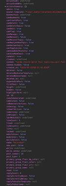

This is where the helper comes in handy, the post attributes are passed to the helper, so you can do a quick
console.log(helper)
You’ll be able to see all the post attributes available for you to work with.
those are just examples, there’s more in there.
