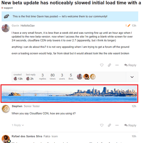

I’d like to add a customer banner (for affiliate purposes) inside of my Posts. Specifically, I’d like to add this block of (example) HTML right after <article id="post_1...".
<div id="custom-ad">
    <a href="example.com">
        <img src="https://picsum.photos/id/74/750/90">
    </a>
</div>
Therefore, looking something like this:
I’ve had limited success with CSS :after. And so was wondering if this is something that could be done from inside the </HEAD> using a <script> like this example.
EDIT: Having played around with it a little more, it seems cleaner to insert the banner at the end of <div class="topic-map"> instead.:
    <section class="map map-collapsed">...</section>
    CUSTOM HTML HERE
</div>

Posts are widgets which means what you’re trying to do will involve a bit more work that just adding html.
Discourse themes have the ability to decorate widgets so you can leverage on that.
Decorating a widget is explained in the link above so let’s focus on what you’re trying to do - add markup after the first post in every topic.
Start by adding the markup to all posts. So something like this
api.decorateWidget("post:after", helper => {
  return helper.h("div", "test text");
</script>
to the header section of your theme. That should be enough to add “test text” below every post.

However, there’s still a problem here, the ad will be inserted below every post in the stream, which is not ideal.
This is where the helper comes in handy, the post attributes are passed to the helper, so you can do a quick
console.log(helper)
You’ll be able to see all the post attributes available for you to work with.
those are just examples, there’s more in there.
Luckily, the firstPost attribute is available for us here, so all you have left is to feed that into a conditional that will only render the ad markup if it’s indeed the first post, otherwise nothing happens. So something like this:
  const firstPost = helper.attrs.firstPost;
  const h = helper.h;
  if (firstPost) {
    return h("div#custom-ad", [
      h(
        "a.custom-ad-link",
        { href: "example.com" },
        h("img", { src: "https://picsum.photos/id/74/750/90" })
</script>
and that will insert your ad only after the first post. One additional thing to do here is to add a height to the image, otherwise it will cause jitter as it loads. So like I briefly touched on above, the height attribute for the image tag is a property, so you’re need to add it next to the src
