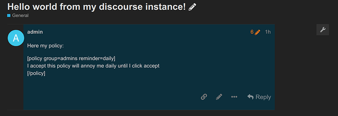

Here the result:
The policy is not rendered in HTML.

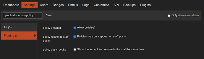

Perhaps make sure you have the plugin enabled in admin-settings policy enabled
Although, if you can use the create policy button on the composer toolbar, then it must be enabled :thinking:

The plugin is enabled:
And I can create a policy with the “Create policy” button.
However, the policy is not rendered in the topic :pensive:

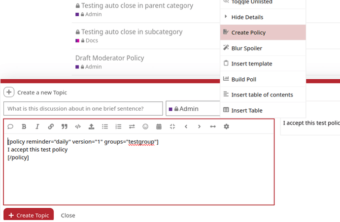

yes @johackim it looks like what Don pointed out. If you use the “Create Policy” button in the extra part of the topic composer toolbar (the gear icon), it does this:
[policy reminder="daily" version="1" groups="testgroup"]
I accept this test policy
[/policy]
I tried all ways (even from the “Create policy” button):

Not sure if the policy_restrict_to_staff_posts setting is getting in your way. Try disabling it?
I tried with an admin and a simple user.
I disabled policy_restrict_to_staff_posts too.
Doesn’t change.

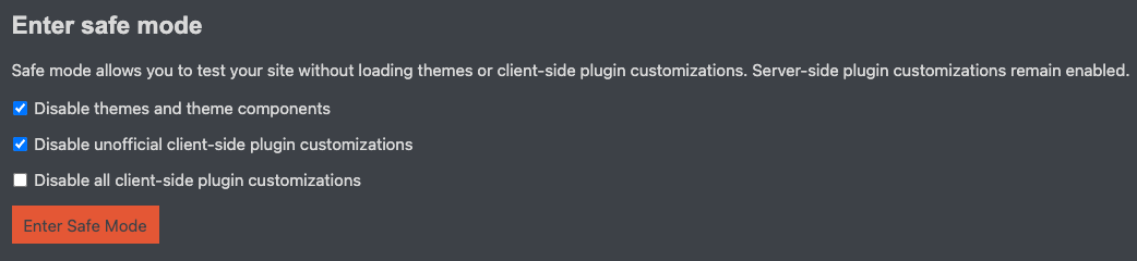

There is something interfering on your site - please try safe mode (add /safe-mode to your site URL) and see if you can get it working with the first two options selected.
You might also want to look in the logs and in the chrome javascript console.

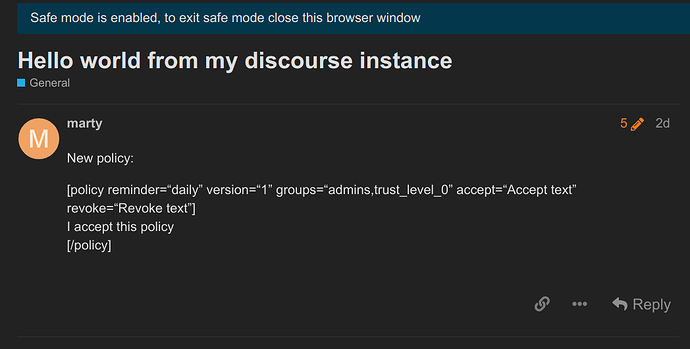

Same thing with the safe mode:

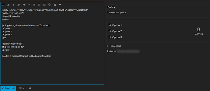

Something weird is going on here. Before you post the policy, does it render in the editor previewer?
I can copy and paste your code and successfully create policy posts. So I am thinking it is something else like the BBcode rendering or a broken plugin even. Are you able to successfully render some of the other editor toolbar functions, like build poll, blur spoiler or hide details?
Here the editor preview:
The display seems to work in this editor preview mode.

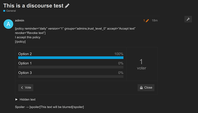

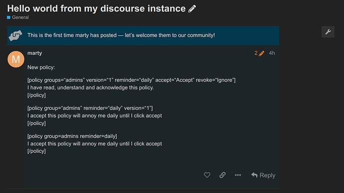

And here the render:
The “pool” plugin works well.
The spoiler plugin doesn’t seem to render HTML either.
