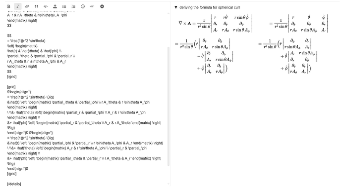

请看这张截图,布局看起来是正确的,但 [grid] 却显示为文本:
:backhand_index_pointing_right: 截图 1:[grid] 在正确渲染的同时,BBCode 标签也可见

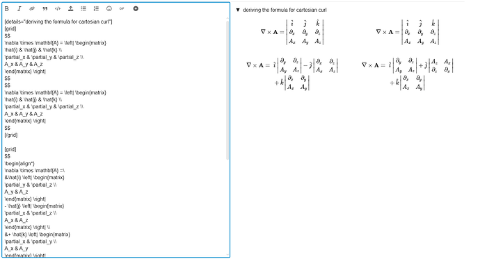

:white_check_mark: 解决方案
[grid] 中使用 $$...$$(块级 LaTeX)而不是行内 $...$,以确保正确渲染。例如:
[grid]
\nabla \times \mathbf{A} = \left| \begin{matrix}
\hat{i} & \hat{j} & \hat{k} \\
\partial_x & \partial_y & \partial_z \\
A_x & A_y & A_z
\end{matrix} \right|
A_x & A_y & A_z
[/grid]
所以我想更新管理面板上的所有内容,然后开始做一些测试
[details="推导笛卡尔旋度公式"]
[grid]
A_x & A_y & A_z
A_x & A_y & A_z
[/grid]
[grid]
\begin{align*}
\nabla \times \mathbf{A} = & \hat{i} \left| \begin{matrix}
A_y & A_z
- \hat{j} \left| \begin{matrix}
\partial_x & \partial_z \\
A_x & A_z
\end{matrix} \right| \\
&+ \hat{k} \left| \begin{matrix}
\partial_x & \partial_y \\
A_x & A_y
\end{align*}
\begin{align*}
A_y & A_z
+ \hat{j} \left| \begin{matrix}
A_z & A_x \\
\partial_z & \partial_x
A_x & A_y
\end{align*}
[/grid]
[/details]

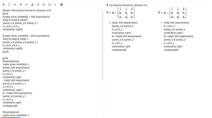

通过 :white_check_mark:
AI 弄错了,在网格中的两个 $...$ 之间添加了过多的空格
[grid]
$\nabla \times \mathbf{A} = \left| \begin{matrix}
A_x & A_y & A_z
\end{matrix} \right|$
A_x & A_y & A_z
[/grid]
[grid]
$\begin{aligned}
A_y & A_z
A_x & A_z
A_x & A_y
\end{aligned}$
$\begin{aligned}
A_y & A_z
A_z & A_x \\
A_x & A_y
\end{aligned}$
[/grid]
[/details]
失败 :cross_mark:

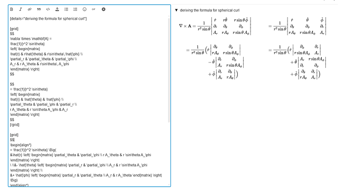

[details="推导球坐标旋度公式"]
[grid]
\frac{1}{r^2 \sin\theta}
\hat{r} & r\hat{\theta} & r\sin\theta\,\hat{\phi} \\
\partial_r & \partial_\theta & \partial_\phi \\
A_r & r A_\theta & r\sin\theta\, A_\phi
= \frac{1}{r^2 \sin\theta}
\hat{r} & \hat{\theta} & \hat{\phi} \\
\partial_\theta & \partial_\phi & \partial_r \\
r A_\theta & r \sin\theta A_\phi & A_r
[/grid]
[grid]
$\begin{align}
= \frac{1}{r^2 \sin\theta} \Big(
& \hat{r} \left| \begin{matrix} \partial_\theta & \partial_\phi \\ r A_\theta & r \sin\theta A_\phi \end{matrix} \right|
& - \hat{\theta} \left| \begin{matrix} \partial_r & \partial_\phi \\ A_r & r \sin\theta A_\phi \end{matrix} \right| \\
& + \hat{\phi} \left| \begin{matrix} \partial_r & \partial_\theta \\ A_r & r A_\theta \end{matrix} \right|
\end{align}$ $\begin{align}
& \hat{r} \left| \begin{matrix} \partial_\phi & \partial_r \\ r \sin\theta A_\phi & A_r \end{matrix} \right|
& + \hat{\theta} \left| \begin{matrix} A_r & r \sin\theta A_\phi \\ \partial_r & \partial_\phi \end{matrix} \right| \\
& + \hat{\phi} \left| \begin{matrix} \partial_\theta & \partial_r \\ r A_\theta & A_r \end{matrix} \right|
\end{align}$ [/grid]
[/details]

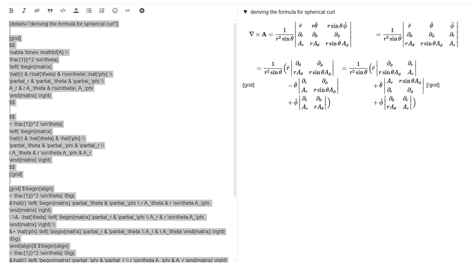

[grid]
[/grid]
[grid] $\begin{align}
\Big)
[/details]
那里失败了
:warning: 问题在于我在 [grid] → object 和/或 object → [/grid] 之间添加了太少的空格
1 个赞

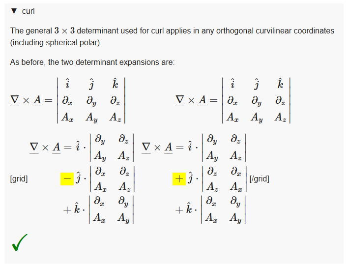

我以为我至少应该提供数学上准确的信息,而不是ChatGPT的胡言乱语 :grinning_face:
\frac{1}{r^2 \sin\theta} \left| \begin{matrix} \textcolor{orange}{\hat{r}} & r\hat{\theta} & r\sin\theta\, \hat{\phi} \\ \partial_r & \boxed{\partial_\theta} & \boxed{\partial_\phi} \\ A_r & \boxed{r A_\theta} & \boxed{r\sin\theta\, A_\phi} \end{matrix} \right|
Curl 的第一项
[center]
\Huge \frac{1}{r^2 \sin\theta} \cdot \textcolor{orange}{\hat{r}}\begin{vmatrix} \partial_\theta & \partial_\phi \\ r A_\theta & r\sin\theta\, A_\phi \end{vmatrix}
[/center]
\textcolor{red}{ \frac{1}{r^2 \sin\theta} \left| \begin{matrix} \hat{r} & \textcolor{purple}{r\hat{\theta}} & r\sin\theta\, \hat{\phi} \\ \left|\overrightarrow{\partial_r}\right| & \partial_\theta & \left|\overrightarrow{\;\;\;\;\partial_\phi\;\;\;\;}\right. \\ \left|\underrightarrow{A_r}\right| & r A_\theta & \underrightarrow{\biggl| \, r\sin\theta\, A_\phi \,} \end{matrix} \right| }
\textcolor{green}{ \frac{1}{r^2 \sin\theta} \left| \begin{matrix} \hat{r} & \textcolor{purple}{r\hat{\theta}} & r\sin\theta\, \hat{\phi} \\ \left|\overrightarrow{\partial_r}\right. & \partial_\theta & \left.\overrightarrow{\;\;\;\;\partial_\phi\;\;\;\;}\right| \\ \left|\underrightarrow{A_r}\right. & r A_\theta & \underrightarrow{ \, r\sin\theta\, A_\phi \, \biggl|} \end{matrix} \right| }
Curl 的第二项
[center]
\Huge \textcolor{red}{- \frac{1}{r^2 \sin\theta} \cdot \textcolor{purple}{r\hat{\theta}}\begin{vmatrix} \partial_\phi & \partial_r \\ r\sin\theta\, A_\phi & A_r \end{vmatrix} }
\Huge \textcolor{green}{+ \frac{1}{r^2 \sin\theta} \cdot \textcolor{purple}{r\hat{\theta}}\begin{vmatrix} \partial_r & \partial_\phi \\ A_r & r\sin\theta\, A_\phi \end{vmatrix} }
[/center]
\frac{1}{r^2 \sin\theta} \left| \begin{matrix} \hat{r} & r\hat{\theta} & \textcolor{blue}{r\sin\theta\, \hat{\phi}} \\ \boxed{\partial_r} & \boxed{\partial_\theta} & \partial_\phi \\ \boxed{A_r} & \boxed{r A_\theta} & r\sin\theta\, A_\phi \end{matrix} \right|
Curl 的第三项
[center]
\Huge \frac{1}{r^2 \sin\theta} \cdot \textcolor{blue}{r\sin\theta\, \hat{\phi}}\begin{vmatrix} \partial_r & \partial_\theta \\ A_r & r A_\theta \end{vmatrix}
[/center]
我创建了另一个主题,关于在 details 面板标题中着色文本,这可以与特定元素的 3 种颜色相匹配
