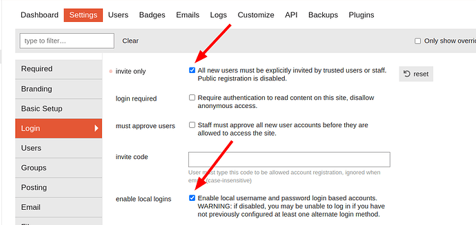

Just to confirm, is it correct that you have configured Google logins for your site, and have the invite only and enable local logins settings enabled?
If so, I’m wondering if you would get the behavior you’re looking for by disabling the enable local logins setting. Before testing that, note that if I works like I think it will, it would force all invited users who have previously set a password on the site to login via Google.

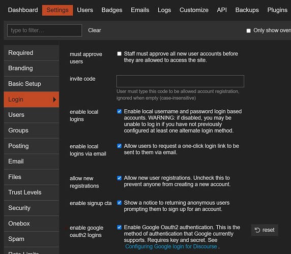

Here is my portion of that form. Note that the invite only checkmark is missing. I cannot find this setting anywhere, now. I ultimately want invite only, but I can’t even change it to experiment at the moment.
The site is enforcing invite only, and I recall setting that when I created the site. I just cannot find that setting now that the site is created. I can try turning off local logins just to see what that would do. I’m going to want that feature back however. The idea is invite only going out to new users who can choose to create a local account or link google/etc. as they choose.

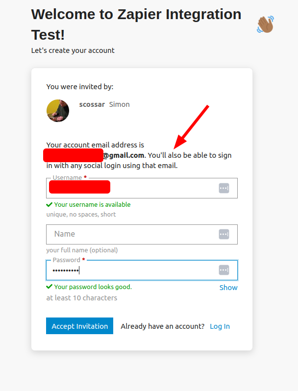

The text on the signup modal lets users know that they’ll be able to login with any social logins using their email address. I think users will understand this to mean that they’ll be able to sign in with Google the next time they login to the site.
With the username/password signup, users are logged directly into the site when they click the “Accept Invitation” button, so the only friction I can see is that they are forced to enter a password before they can initially access the site.
I don’t think there is any way to get the “Sign in with Google” button to display on the invite modal if local logins are enabled.
