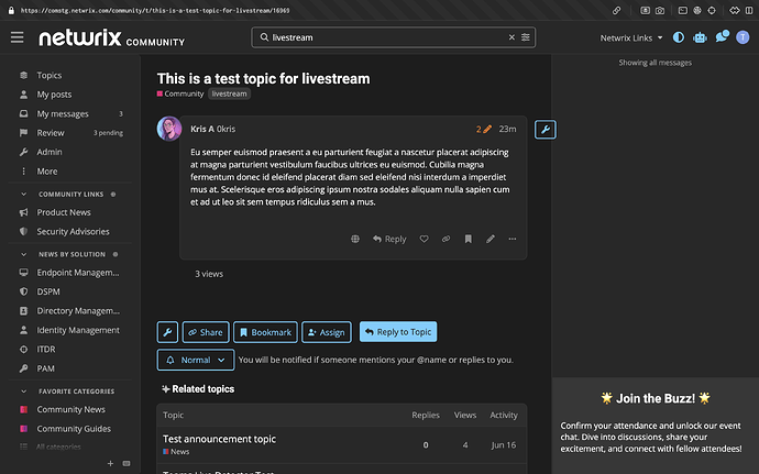

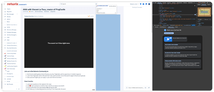

聊天和主题容器之间存在较大差距
当我们为活动触发 livestream 聊天时,div.container.post::before 中会出现这个很大的空白。在用标签触发转换之前,间距都是正常的。
我尝试调整 CSS 来修改这个元素,但没能弄明白。如果我隐藏 ::before,则会出现 ::after。当我隐藏两者时,间距仍然存在。
如果有人想在线查看,可以在此页面上查看。

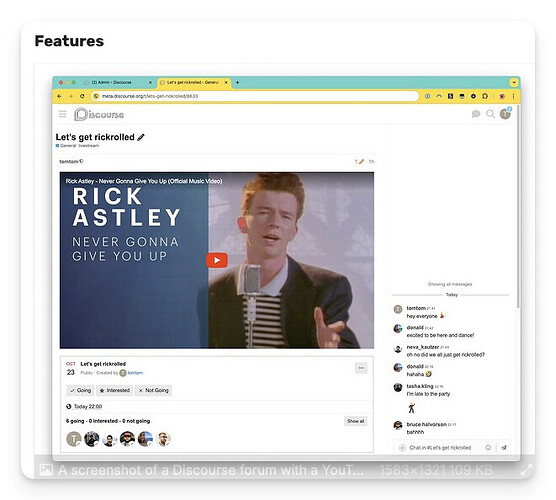

官方截图没有出现这个间距,所以我不太清楚是怎么回事:
The spacing should be for the topic timeline (image above for reference), which is why without the clearfixes the space is still present. There is still space for the timeline, even if there is only one post and even if you are not admin, where the timeline would appear empty and appears as empty space.

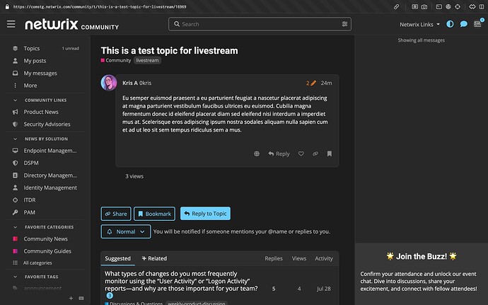

For Admins (see the floating button):
For Non-Admins:
If you want a little space for the settings button, you can adjust or tweak this part:
grid-template-columns: 90% 10%;
grid-template-columns: calc(100% - 80px) 80px;
Does this help understand what is going on with the layout or assist fully? We see that the clearfix in your screenshot takes up a slightly different spacing than we were able to replicate, so we aren’t 100% certain if this addresses the issue.
I would personally leave it as-is for consistency with the timeline being available or not available, but if you want to make changes to it, the css above should be sufficient for taking up the full width when the topic timeline is empty. Let us know if you have any issues with this or need help with implementation! Thanks.
