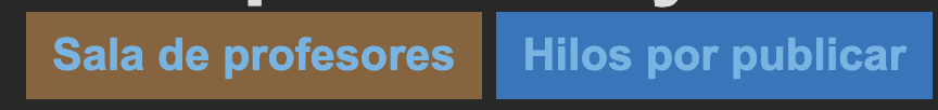

The category style setting is for the style of the category badges, not the layout of a category page:
This is the ‘box’ version:
Versus the default ‘bullet’:
With the introduction of the sidebar and hashtag-autocomplete, those styles now don’t translate as well across all elements of the UI, and as most sites stick to the default it makes sense to create a theme component for those that do still want it and to remove the setting from core to simplify things overall.

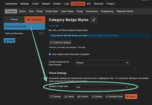

If I understand Blake correctly in the first post, nothing will be taken away here and you will be able to configure your site to behave as it does currently using the new GitHub - discourse/discourse-category-badge-styles: Adds the box and bar style for Discourse categories theme component. Just install that and set the category style to none. You can do that right away, even though it does not have any effect yet while the category style site setting exists.
Here’s what the theme complnent setting looks like:

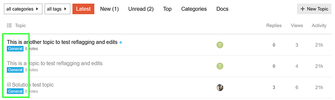

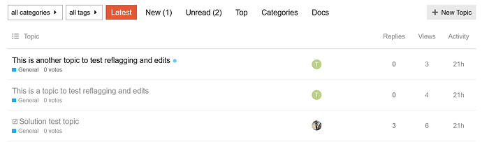

I just tried it on my site and saw a significant styling difference for the ‘box’ option.
This is how it looks without the theme component:
And with the theme component (larger padding from .badge-wrapper.box and blue font from var(--category-badge-text-color)):

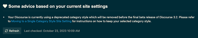

So how exactly to revert to the default to get rid of the warning? Setting Category badge style to bullet?
Yes, that’s correct. No immediate urgency to change anything but you will get a warning on the admin home page until you do.
