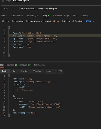

New signup with old email including + doesnt work in rest API
It seems in a recent update, new signup with same email including a + to represent a new email isnt allowed. my system is highly dependent on it. how to enable it again?
for example if I have already signup with email@gmail.com, I cant signup with email+1@gmail.com
btw I am testing this with rest api

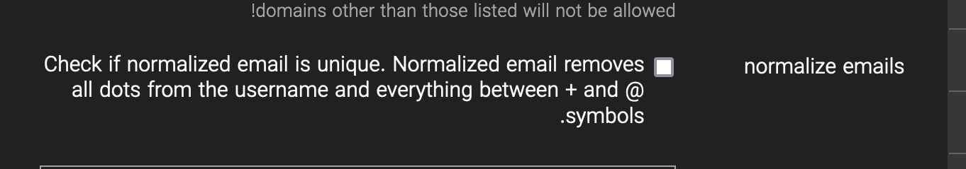

also, I dont have this option checked:
I believe that’s the normalize emails admin setting: :+1:
Edit: I did not see that edit before I posted. :slight_smile:
yes it is already disabled for me

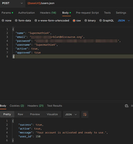

I can’t duplicate this on try.discourse.org.
Can you sign up from the normal UI with this email?
Also, can you double check the +1 email wasn’t already used for a signup?
yes normal UI is ok. rest api is not ok.
I did exactly the same and could not duplicate the problem on the latest code running live - it behaved as expected with the normalize emails setting disabled:

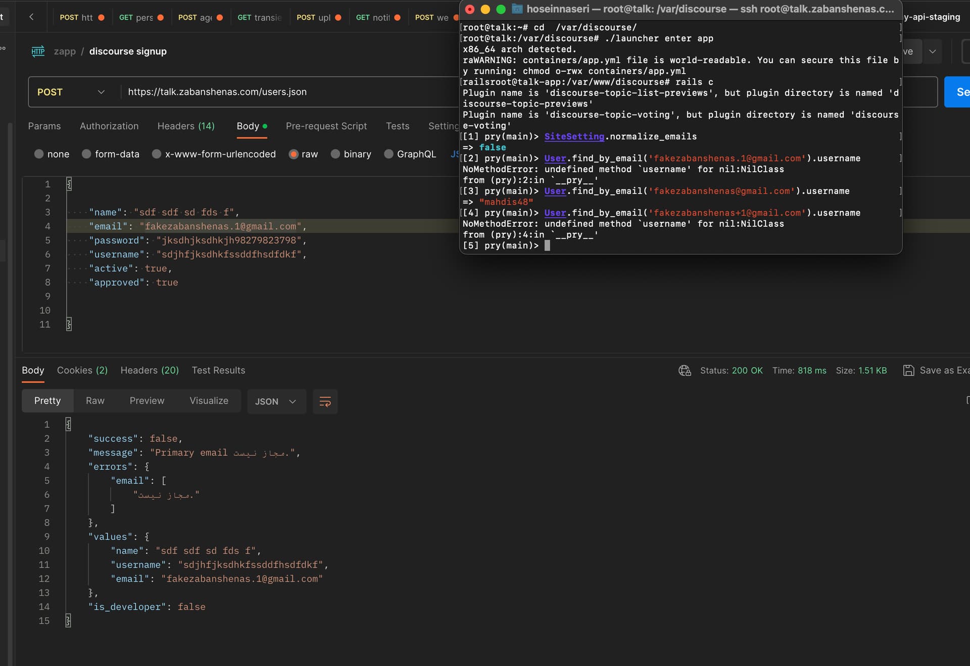

Can you show the output of these from the rails console:
[1] pry(main)> SiteSetting.normalize_emails
[2] pry(main)> User.find_by_email('YOURUSERNAME@gmail.com').username
[3] pry(main)> User.find_by_email('YOURUSERNAME+1@gmail.com').username

I updated right now
here it is
What do these translate to?
(and can you copy/paste them here)
I should have asked this first :man_facepalming:
“Primary email is not allowed.”
it is a translation for user.email.blocked
