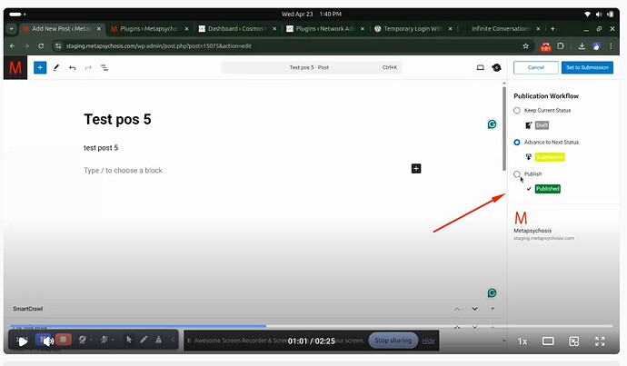

Thanks for following up. Here are the details:
  • We are using the Gutenberg editor for creating posts.
  • We are not using any custom field plugins such as Advanced Custom Fields.
  • I’ve recorded a video replicating the issue for your review. You can check it here.
Let me know if you need any additional information or further testing.
If it helps, I can also provide temporary login access so you can explore the setup directly.
Thanks!
Thanks for recording the video. It seems you’re using a custom publication workflow to publish posts.
This may be connected to the issue.
Are you able to try publishing posts without this custom workflow? The way we will get to the bottom of this is a process of elimination. It is likely that one of your customisations is not interoperable with the WP Discourse publish feature set.
