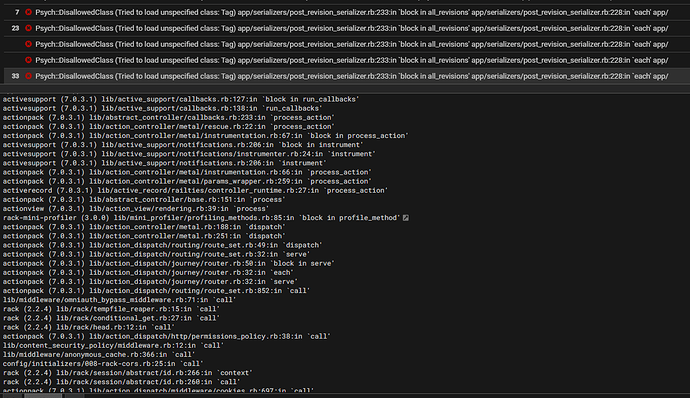

Potresti provare a visitare /logs sul tuo sito e vedere se ci sono log di errori recenti? In particolare, stiamo cercando quelli che iniziano con Psych::DisallowedClass.
2 Mi Piace
Certo. Ho un sacco di errori Psych.
La domanda è: quale ti serve? :slight_smile:
/usr/local/lib/ruby/2.7.0/psych/class_loader.rb:97:in `find'
/usr/local/lib/ruby/2.7.0/psych/class_loader.rb:28:in `load'
/usr/local/lib/ruby/2.7.0/psych/visitors/to_ruby.rb:411:in `resolve_class'
/usr/local/lib/ruby/2.7.0/psych/visitors/to_ruby.rb:208:in `visit_Psych_Nodes_Mapping'
/usr/local/lib/ruby/2.7.0/psych/visitors/visitor.rb:16:in `visit'
/usr/local/lib/ruby/2.7.0/psych/visitors/visitor.rb:6:in `accept'
/usr/local/lib/ruby/2.7.0/psych/visitors/to_ruby.rb:32:in `accept'
/usr/local/lib/ruby/2.7.0/psych/visitors/to_ruby.rb:332:in `block in register_empty'
/usr/local/lib/ruby/2.7.0/psych/visitors/to_ruby.rb:332:in `each'
/usr/local/lib/ruby/2.7.0/psych/visitors/to_ruby.rb:332:in `register_empty'
/usr/local/lib/ruby/2.7.0/psych/visitors/to_ruby.rb:141:in `visit_Psych_Nodes_Sequence'
/usr/local/lib/ruby/2.7.0/psych/visitors/to_ruby.rb:340:in `block in revive_hash'
/usr/local/lib/ruby/2.7.0/psych/visitors/to_ruby.rb:338:in `each'
/usr/local/lib/ruby/2.7.0/psych/visitors/to_ruby.rb:338:in `each_slice'
/usr/local/lib/ruby/2.7.0/psych/visitors/to_ruby.rb:338:in `revive_hash'
/usr/local/lib/ruby/2.7.0/psych/visitors/to_ruby.rb:162:in `visit_Psych_Nodes_Mapping'
/usr/local/lib/ruby/2.7.0/psych/visitors/to_ruby.rb:313:in `visit_Psych_Nodes_Document'
/usr/local/lib/ruby/2.7.0/psych.rb:360:in `safe_load'
activerecord (7.0.3.1) lib/active_record/coders/yaml_column.rb:50:in `yaml_load'
activerecord (7.0.3.1) lib/active_record/coders/yaml_column.rb:26:in `load'
activerecord (7.0.3.1) lib/active_record/type/serialized.rb:22:in `deserialize'
activemodel (7.0.3.1) lib/active_model/type/helpers/mutable.rb:8:in `cast'
activemodel (7.0.3.1) lib/active_model/attribute.rb:179:in `type_cast'
activemodel (7.0.3.1) lib/active_model/attribute.rb:43:in `value'
activemodel (7.0.3.1) lib/active_model/attribute_set.rb:46:in `fetch_value'
activerecord (7.0.3.1) lib/active_record/attribute_methods/read.rb:38:in `_read_attribute'
activemodel (7.0.3.1) lib/active_model/attribute_methods.rb:277:in `modifications'
app/serializers/post_revision_serializer.rb:233:in `block in all_revisions'
app/serializers/post_revision_serializer.rb:228:in `each'
app/serializers/post_revision_serializer.rb:228:in `all_revisions'
app/serializers/post_revision_serializer.rb:187:in `revisions'
app/serializers/post_revision_serializer.rb:254:in `previous'
app/serializers/post_revision_serializer.rb:50:in `previous_hidden'
(eval):5:in `_fast_attributes'
active_model_serializers (0.8.4) lib/active_model/serializer.rb:456:in `attributes'
active_model_serializers (0.8.4) lib/active_model/serializer.rb:480:in `_serializable_hash'
active_model_serializers (0.8.4) lib/active_model/serializer.rb:359:in `serializable_hash'
active_model_serializers (0.8.4) lib/active_model/serializer.rb:347:in `as_json'
activesupport (7.0.3.1) lib/active_support/json/encoding.rb:22:in `encode'
activesupport (7.0.3.1) lib/active_support/core_ext/object/json.rb:42:in `to_json'
active_model_serializers (0.8.4) lib/active_model/serializer.rb:331:in `to_json'
multi_json (1.15.0) lib/multi_json/adapters/oj.rb:56:in `dump'
multi_json (1.15.0) lib/multi_json/adapter.rb:25:in `dump'
multi_json (1.15.0) lib/multi_json.rb:139:in `dump'
app/controllers/application_controller.rb:547:in `render_json_dump'
app/controllers/posts_controller.rb:428:in `latest_revision'
actionpack (7.0.3.1) lib/action_controller/metal/basic_implicit_render.rb:6:in `send_action'
actionpack (7.0.3.1) lib/abstract_controller/base.rb:215:in `process_action'
actionpack (7.0.3.1) lib/action_controller/metal/rendering.rb:53:in `process_action'
actionpack (7.0.3.1) lib/abstract_controller/callbacks.rb:234:in `block in process_action'
activesupport (7.0.3.1) lib/active_support/callbacks.rb:118:in `block in run_callbacks'
app/controllers/application_controller.rb:415:in `block in with_resolved_locale'
i18n (1.12.0) lib/i18n.rb:322:in `with_locale'
app/controllers/application_controller.rb:415:in `with_resolved_locale'
activesupport (7.0.3.1) lib/active_support/callbacks.rb:127:in `block in run_callbacks'
activesupport (7.0.3.1) lib/active_support/callbacks.rb:138:in `run_callbacks'
actionpack (7.0.3.1) lib/abstract_controller/callbacks.rb:233:in `process_action'
actionpack (7.0.3.1) lib/action_controller/metal/rescue.rb:22:in `process_action'
actionpack (7.0.3.1) lib/action_controller/metal/instrumentation.rb:67:in `block in process_action'
activesupport (7.0.3.1) lib/active_support/notifications.rb:206:in `block in instrument'
activesupport (7.0.3.1) lib/active_support/notifications/instrumenter.rb:24:in `instrument'
activesupport (7.0.3.1) lib/active_support/notifications.rb:206:in `instrument'
actionpack (7.0.3.1) lib/action_controller/metal/instrumentation.rb:66:in `process_action'
actionpack (7.0.3.1) lib/action_controller/metal/params_wrapper.rb:259:in `process_action'
activerecord (7.0.3.1) lib/active_record/railties/controller_runtime.rb:27:in `process_action'
actionpack (7.0.3.1) lib/abstract_controller/base.rb:151:in `process'
actionview (7.0.3.1) lib/action_view/rendering.rb:39:in `process'
rack-mini-profiler (3.0.0) lib/mini_profiler/profiling_methods.rb:85:in `block in profile_method'
actionpack (7.0.3.1) lib/action_controller/metal.rb:188:in `dispatch'
actionpack (7.0.3.1) lib/action_controller/metal.rb:251:in `dispatch'
actionpack (7.0.3.1) lib/action_dispatch/routing/route_set.rb:49:in `dispatch'
actionpack (7.0.3.1) lib/action_dispatch/routing/route_set.rb:32:in `serve'
actionpack (7.0.3.1) lib/action_dispatch/journey/router.rb:50:in `block in serve'
actionpack (7.0.3.1) lib/action_dispatch/journey/router.rb:32:in `each'
actionpack (7.0.3.1) lib/action_dispatch/journey/router.rb:32:in `serve'
actionpack (7.0.3.1) lib/action_dispatch/routing/route_set.rb:852:in `call'
lib/middleware/omniauth_bypass_middleware.rb:71:in `call'
rack (2.2.4) lib/rack/tempfile_reaper.rb:15:in `call'
rack (2.2.4) lib/rack/conditional_get.rb:27:in `call'
rack (2.2.4) lib/rack/head.rb:12:in `call'
actionpack (7.0.3.1) lib/action_dispatch/http/permissions_policy.rb:38:in `call'
lib/middleware/anonymous_cache.rb:366:in `call'
config/initializers/008-rack-cors.rb:25:in `call'
rack (2.2.4) lib/rack/session/abstract/id.rb:266:in `context'
rack (2.2.4) lib/rack/session/abstract/id.rb:260:in `call'
actionpack (7.0.3.1) lib/action_dispatch/middleware/cookies.rb:697:in `call'
actionpack (7.0.3.1) lib/action_dispatch/middleware/callbacks.rb:27:in `block in call'
activesupport (7.0.3.1) lib/active_support/callbacks.rb:99:in `run_callbacks'
actionpack (7.0.3.1) lib/action_dispatch/middleware/callbacks.rb:26:in `call'
actionpack (7.0.3.1) lib/action_dispatch/middleware/debug_exceptions.rb:28:in `call'
actionpack (7.0.3.1) lib/action_dispatch/middleware/show_exceptions.rb:26:in `call'
logster (2.11.3) lib/logster/middleware/reporter.rb:43:in `call'
railties (7.0.3.1) lib/rails/rack/logger.rb:40:in `call_app'
railties (7.0.3.1) lib/rails/rack/logger.rb:27:in `call'
config/initializers/100-quiet_logger.rb:23:in `call'
config/initializers/100-silence_logger.rb:31:in `call'
actionpack (7.0.3.1) lib/action_dispatch/middleware/remote_ip.rb:93:in `call'
actionpack (7.0.3.1) lib/action_dispatch/middleware/reque
Messaggio (33 copie riportate)
Psych::DisallowedClass (Tentativo di caricare una classe non specificata: Tag)
lib/middleware/enforce_hostname.rb:23:in `call'
lib/middleware/request_tracker.rb:202:in `call'
Backtrace
Env
HTTP HOSTS: forum.empyrion-homeworld.net
lib/middleware/anonymous_cache.rb:368:in `call'
1 Mi Piace
