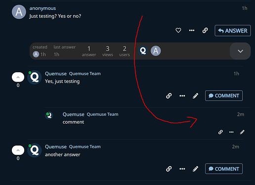

  4. When a post has comments, it does not have the ‘show comments’:
  5. In your sandbox I noticed that if you click ‘show comments’ you can’t undo it (close the comments section).
