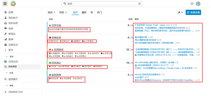

After the recent rebuild update, the homepage font became very small
After the recent rebuild update, the font size for subcategory names and the latest topic titles on the homepage (when categories are set as the homepage) has become very small. How can I increase the font size within the red box on this page?

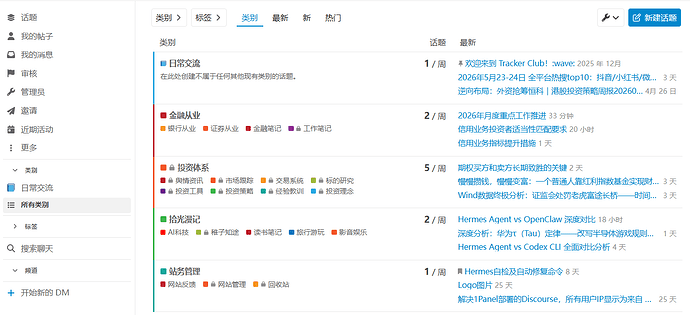

Can confirm. Same issue when using Foundation, and when the homepage uses categories and features topics.
disabling / re-enabling the modernize foundation theme in upcoming changes effect in categories with featured topics mode:

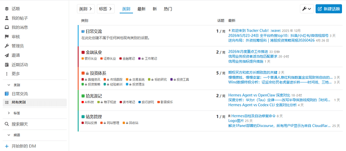

I’m not sure if it’s just my imagination, but when I switch back to the default Foundation theme, even though the font is larger, the line spacing still feels a bit narrower than before the upgrade. :rofl:
i suspect that perhaps the removed/replaced padding property affected some of the vertical spacing:
Seems so. Even after reverting to the default Foundation theme, the line spacing in the recent topics row on the right side of the category page still seems a bit narrow. @jordan.vidrine, could you fix this? :grinning_face:

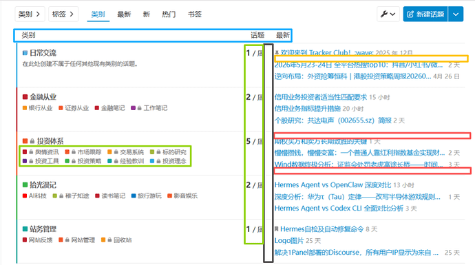

In summary:
  1. Increase the font size of the subcategories and weekly post count (green box)
  2. Increase the font size of the ā€œLatest Topicsā€ text on the right
  3. Increase the font size of the ā€œCategoriesā€, ā€œTopicsā€, and ā€œLatestā€ (blue box) text
  4. Increase the spacing in the black box
  5. Increase the line spacing for topic rows on the right (yellow box area)
  6. Ensure the heights in the red box area are consistent
Below is the default display:

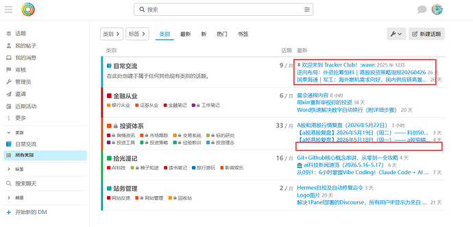

Below is the result after I modified the component CSS:
The component CSS code can be found in this post:
Optimizing the homepage display of the Foundation theme - Development - Discourse Meta
This might be more obvious:
Official default:
After customizing the component:
