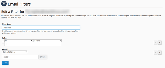

Ok I got this working. Here was the issue:
  1. I am using cPanel for the discourse user.
  2. cPanel supports plus addressing however it routes anything that comes after the ‘+’ sign to its own folder.
  3. The solution was to create an email filter to route any message that had a plus address in the To header to the inbox folder so the Discourse installation could find the message.

@brianemwdさん、ありがとうございます。うまくいきました。
他の人のために、こちらがその様子です。
