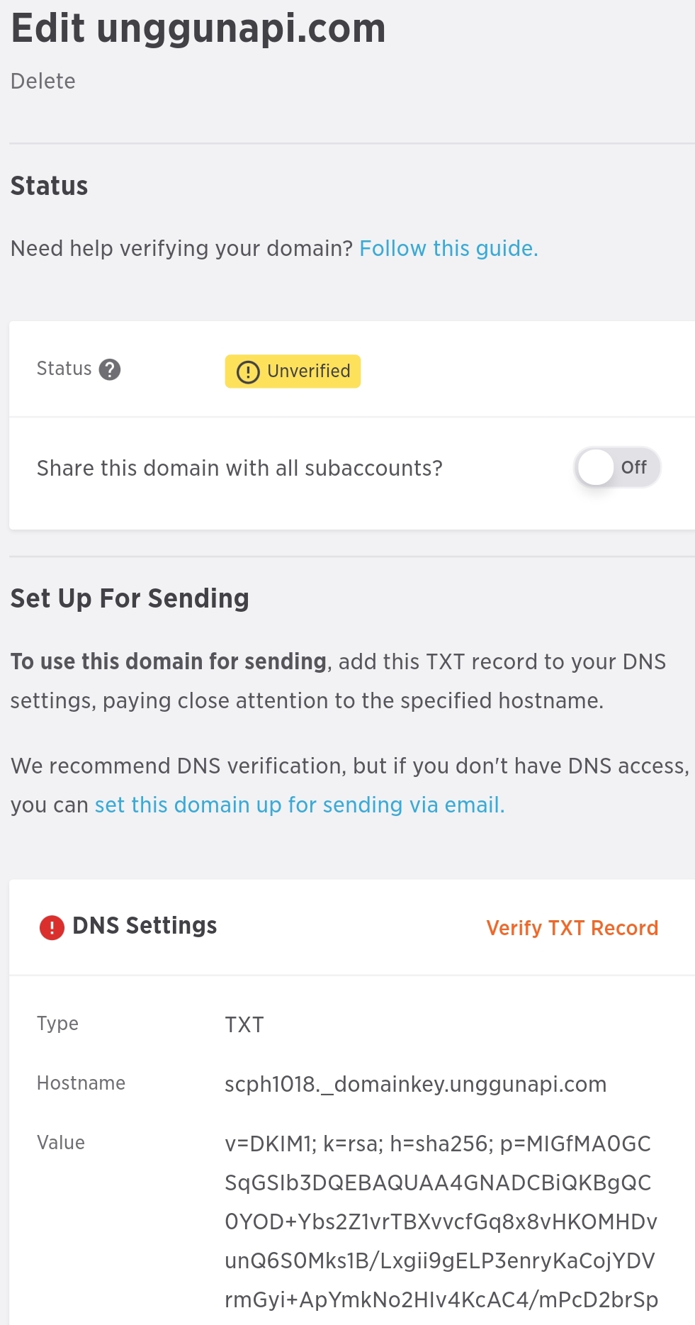

I am following the step to setup the Discourse One Click Application on Digital Ocean and use SparkPost as the SMTP server… but currently stuck at verify sending domain (this is my first time experience with SMTP.. mail server etc)
Below is currently the setting for my domain .. does it look ok? What are the steps that I need to do to actually verify sending domain? I am totally clueless… so any help will be very much appreciated

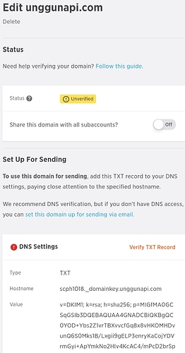

This is the verify sending domain part from SparkPost in case it can help
It looks correct to me, according to Sparkpost’s instructions. But this is a question for Sparkpost, not Discourse.
