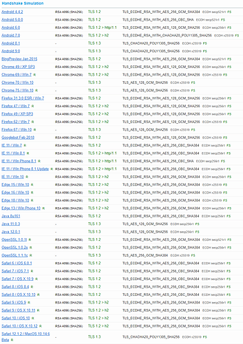

You can test your site using the SSL Server Test. The test results contain a section named “Handshake Simulation” which should show you browser/OS combinations that work / do not work.

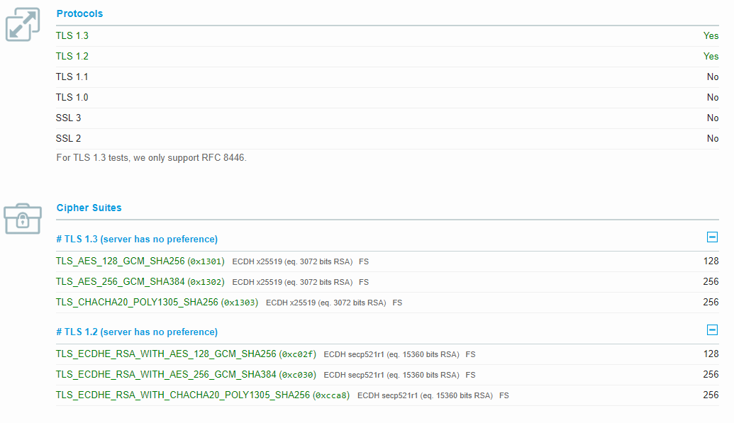

With the latest Docker image I’m seeing the following TLS configuration:
You can send your users to Qualys SSL Labs - Projects / SSL Client Test in order to get more information about their browser and OS versions as well as supported TLS versions.

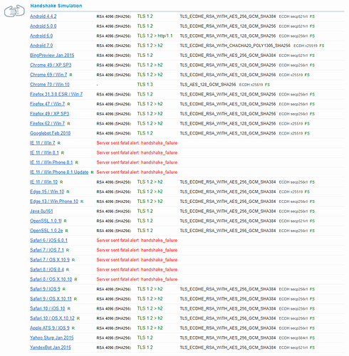

I ran the SSL Server Test and can’t find anything wrong with the result:
https://www.ssllabs.com/ssltest/analyze.html?d=forum.stadtteilgenossenschaft-wik.de&hideResults=on
They are the same as the ones in your post, afaict.
The only failures were for old OS+Safari version (Safari 8+9) and old windows versions with IE 11. That last one concerns me a bit: shouldn’t IE 11 be supported by Discourse and also support TLS 1.2 by default?
The test also doesn’t contain a test for Safari 10 on the oldest still supported OS, so maybe that also fails…

This is the result I see on SSLLabs for my server after applying the config and rebuilding:
According to my understanding, it should list many more, as the config has many more options. Does this mean this config change didn’t work?

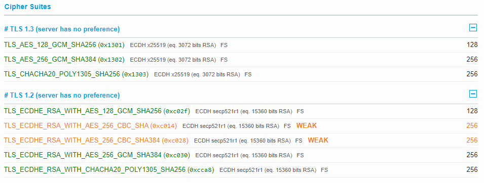

I think the ciphers you chose have the wrong names. Mapping OpenSSL cipher suite names to IANA names is a good resource for mapping between the ciphers listed by the SSL Server Test and the names used by OpenSSL (nginx).
In my tests I appended :ECDHE-RSA-AES256-SHA384:ECDHE-RSA-AES256-SHA and after a rebuild the test looks like this:
Maybe there’s a bug in the test? :man_shrugging: I don’t have such an old Safari for testing. We support only Safari 10+. Are you sure that it still fails due to a TLS error?

Thank you this was the issue and fixing the names makes the handshake work for all browsers tested in the list of SSLLabs. Thank you so much for your patience!
